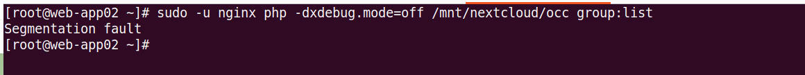

I have this problem, in my server there is a group that cannot display users
When selecting a group, a notification appears
Then I went to the server and ran the command manually, which showed an error
I turned on debug and tried again and got this error
I checked the app and database logs but got no results

It seems your app “External user authentication” enters in a fatal loop. You should first disable it, to check if it’s the problem source.
Thank you, I found the cause of the External user authentication error when logging in with the correct email
