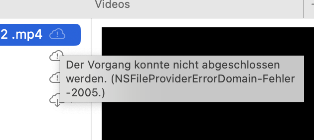

I’m experiencing problems when I try to upload bigger files (the smallest one has about 330 MB, the bigger ones stay below 1GB) via the Nextcloud client for macOS (VFS, client 3.17.2, macOS 15.6.1).
The files do not get uploaded to my Nextcloud and state an error 2005:
The log file of the client states:
Could not upload item with filename: movie.mp4,
received error: -9994
chunk_file_null
received ocId: empty
Uploading the same file via the web interface works without any problems.
