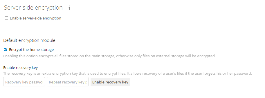

I’ve been enabling encryption against home storage as a matter of default recently, though I just stumbled across this:
Encryption keys are stored only on the Nextcloud server, eliminating exposure of your data to third-party storage providers. The encryption app does not protect your data if your Nextcloud server is compromised, and it does not prevent Nextcloud administrators from reading user’s files. This would require client-side encryption, which this app does not provide. If your Nextcloud server is not connected to any external storage services then it is better to use other encryption tools, such as file-level or whole-disk encryption.
Indeed I noticed I can SSH into the server and see the files in each user directory with no issue.
I’d pictured encryption being done through some process involving keys and the database to chunk uploaded files into useless, undeterminable blobs on disk (that is to say NC does the encryption on the application layer before spitting the result onto disk).
So what is the purpose of home storage encryption if it doesn’t obscure uploads on disk as they’re added please?

I have the encryption turned on my server and i created a new user and placed a file and i was not able to see anything when i opened the file, it looks as it’s encrypted.
@AndyXheli do you have both home and server-side enabled? I’m only using home.
Well that isn’t overly clear.
Thanks Grouch :slight_smile:
I have both enabled.
Default encryption module: Enabled
Server-side encryption: Enabled
Encrypt the home storage: Enabled
maybe I am blind, but I don’t know of any other built-in encryption features?
please specify “home directory encryption” or point to the documentation or admin setting you are talking about.

Feel free to take a look at the screenshots I’ve supplied above.
@Guillaume I reverted your edit because it poses an interesting question -
I hadn’t thought about external storage up to this point, but it would appear it’s mandatory then in order to encrypt home storage.
I really only wanted home storage.
Additionally, would federated shares be affected?
I do not understand the difference in “enable server side encryption” and “encrypt home storage”, and how can you have home storage encryption without enabling server side encryption?
