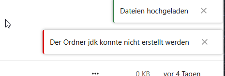

When i try to drag n drop a folder it looks like that…
Ok, I tried without a public shared link, then it works for me. Just the file drop seems to be affected.

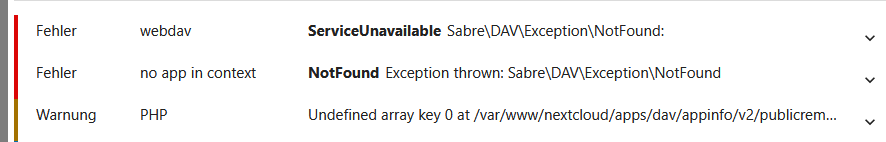

So your case seems to be different. Regarding the errors you found, do you have the full log entries? I’d try to search for these errors, you can often find some hints. For older setups, it can be that some webserver config has slightly changed, some app is not up to date, and you should also make sure to use the latest point-release:
