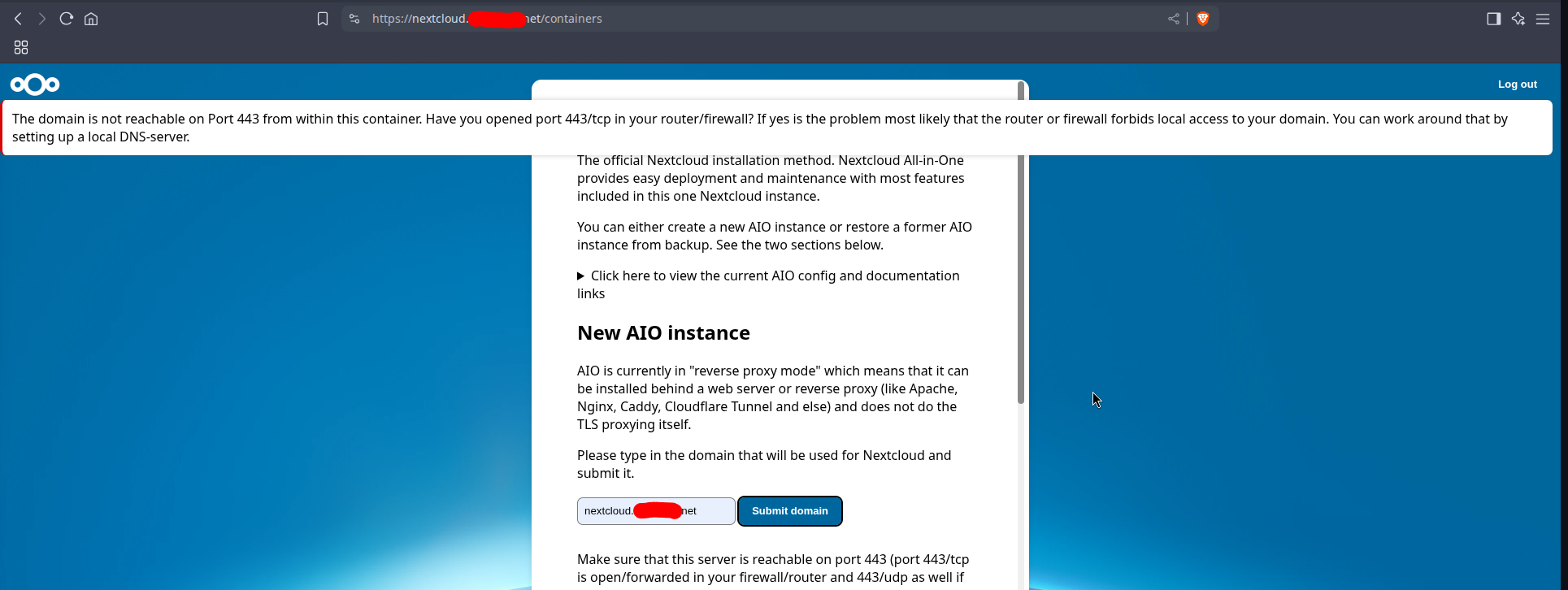

I’m running a local server on local IP 10.0.2.4 with Nginx Proxy Manager and trying to install AIO on it. I have registered my domain with a registrar and pointing at my public IP, but I also have a local DNS server where the domain has an A record pointing to 10.0.2.4.
When I connect to nextcloud.<my domain>.net it successfully connects to the AIO setup screen, with SSL enabled (LetsEncrypt, via Nginx Proxy Manager)
But still, I get the error:
The domain is not reachable on Port 443 from within this container. Have you opened port 443/tcp in your router/firewall? If yes is the problem most likely that the router or firewall forbids local access to your domain. You can work around that by setting up a local DNS-server.

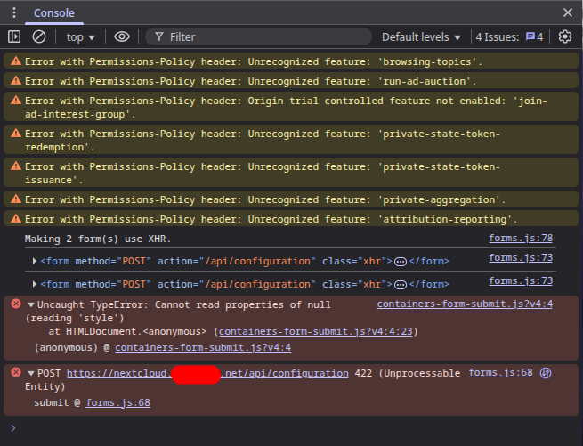

containers-form-submit.js?v4:4 Uncaught TypeError: Cannot read properties of null (reading 'style')
    at HTMLDocument.<anonymous> (containers-form-submit.js?v4:4:23)
(anonymous)	@	containers-form-submit.js?v4:4
forms.js:68
 POST https://nextcloud.<my domain>.net/api/configuration 422 (Unprocessable Entity)
submit	@	forms.js:68

Hi, you might also need to adjust the docker daemon via daemon.json to use the local dns server. See Configuring DNS | dockerlabs
That was the issue, thank you!
