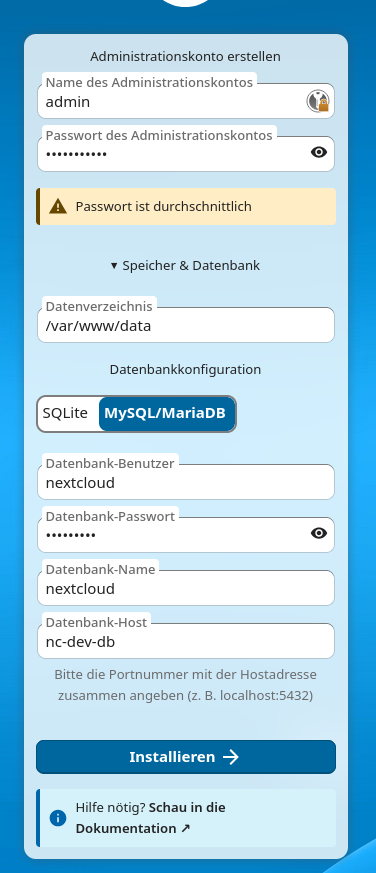

If I start this first thing I get this:
PHP Fatal error: Uncaught PDOException: SQLSTATE[42S02]: Base table or view not found: 1146 Table 'nextcloud.oc_appconfig' doesn't exist in
which makes sense with an empty database. I can connect to the database but not tables are setup.
solved. there was a spurious /config/config.php from a previous attempt .
So steps to reset the server:
  • remove the containers
  • remove the volume nc-dev-db
  • remove the /config/config.php file
  • remove the nextcloud-data folder
