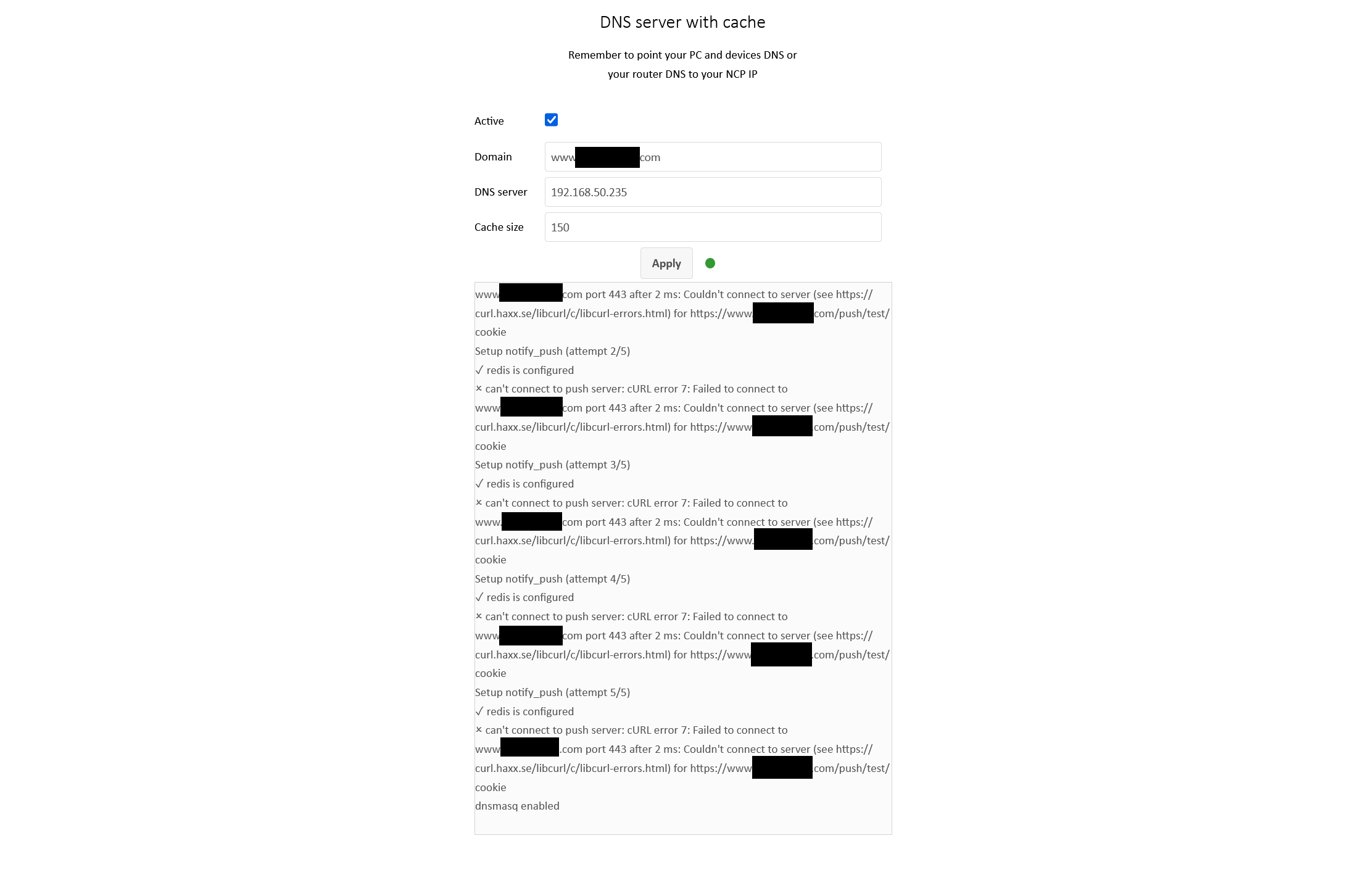

Here’s a screenshot of my dnsmasq settings where the DNS server is the IP address of a piHole on my network:

According to your screenshot, it looks like you are using Nextcloud Pi.
I’m afraid I don’t have much experience with it, but I’d say it shouldn’t be necessary to manually change anything in the web server configuration, as things like Notify Push should already be configured out of the box.
Again, I don’t have much experience with NCP, so I don’t know exactly what is going on here.
Generally, this can happen when your router performs NAT loopback, causing all connections from within your local network to appear to come from your router’s address instead of the device that initiated them.
To avoid this, make sure all client devices use either Dnsmasq on the Pi or another local DNS server that points the domain name to the Pi’s IP address. This is also known as Split Brain DNS.
Is it normal that you have port 443 and 443 (tcp). Normally that should not do anything.
Can you have a logging of your firewall. Then if you try to connect, you can perhaps see which rule applies. In your logic, for a connection, you go through the list from the bottom to the top, and everything that is not explicitly allowed will be rejected in the end?
Ah no, the first entry is just for the 192.168.50.1 which is not allowed to connect anywhere, this isn’t you Nextcloud server or client?
