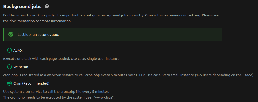

And can you check if the cronjobs are running correctly, you can see that in the Administration menu in the basic settings (the background jobs clean the trash and versions) when they run for the last time.
Yes I can send some information about this system:
Cronjob
