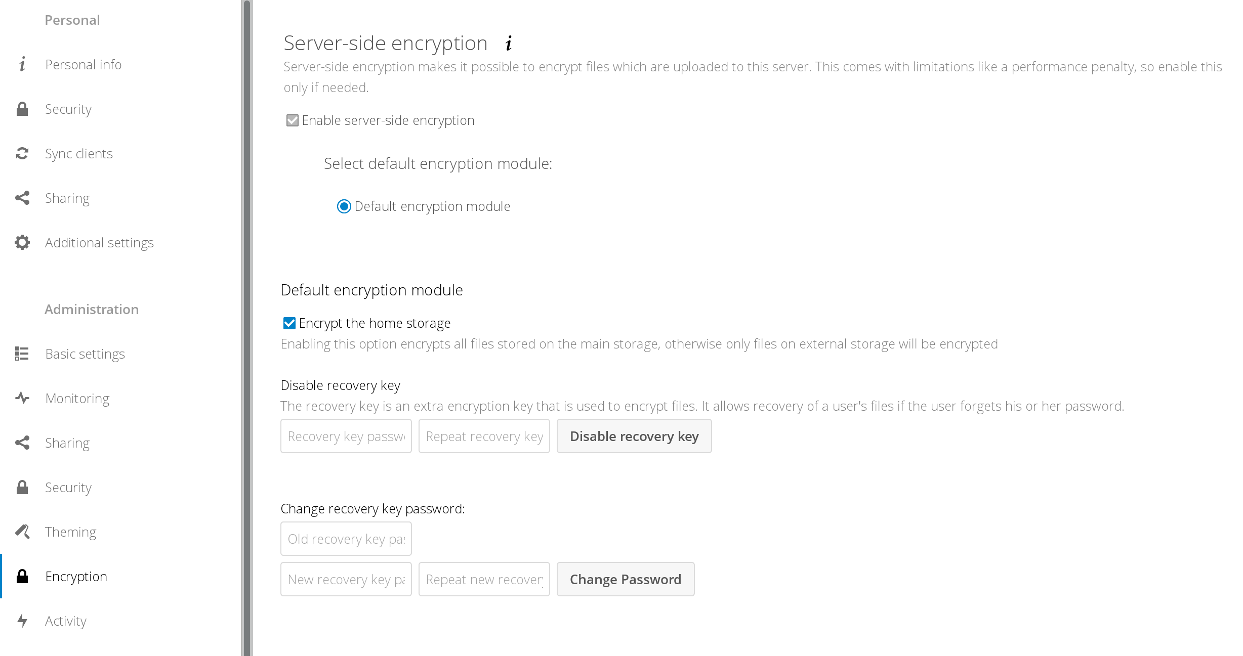

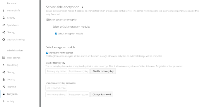

I have two nextcloud 13.0.1, the first one was upgraded from nextcloud 12 and shows the Disable recovery key entry in the /settings/admin/encryption page.

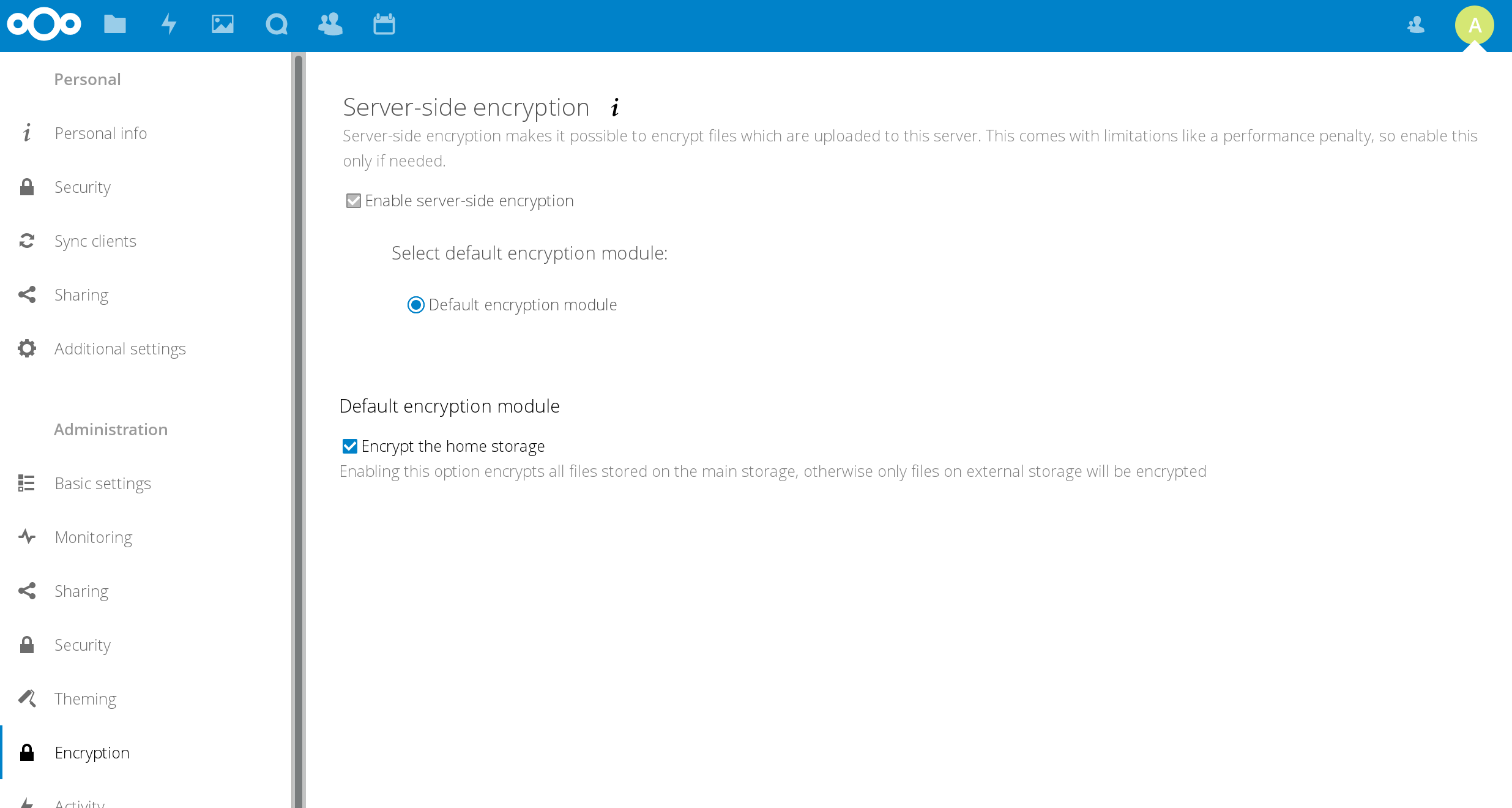

The other was upgraded from nextcloud 13.0.0 and does not show the Disable recovery key entry in the /settings/admin/encryption page.
I assume this happens because something is not activated somewhere but … where ?
Thanks in advance!
Soooo if I understand the above bug report correctly, what it means is that this legacy complexity from 12 disapeared in 13, reason why I can’t find it. Right?
