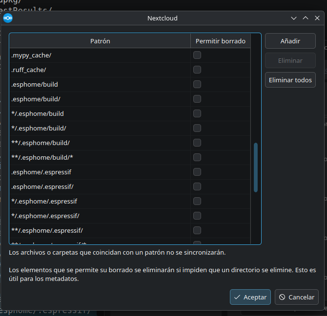

I have a development folder synced, but I don’t want the compilation folders and artifacts to be synchronized, so I created a exclusions file in the root of the share.
The shared folder name is: /home/sergio/Desarrollos
The exclusions file named: .sync-exclude.lst
This is the relevant part of the file:
# ─── ESPHome ──────────────────────────────────────────────────────────────────
**/.esphome/build/
**/.esphome/.espressif/
Folders that always upload are, for example: /home/sergio/Desarrollos/Embedded/esphome-living-display-1/.esphome/build
Whenever I do a compilation, those folders and their contents are fully uploaded.
I’ve tried anything. Closing the client and removing the folders in the server. Removing the logs files and database from the share.
When the client is started again it syncs all the content, including the excluded folders.
I’ve also checked that opening the configuration in the UI and going settings β†’ share β†’ edit exclusions the window that opens has all my entries there.
Is a problem in how I enter the exclusion for a subfolder? (the **). Without that, subfolders and files that had β€œ.” (like file.main.bak) weren’t excluded.
I also tried adding **/.esphome/build/*, but it didn’t work.
I’m running the latest stable versiΓ³n from the official repo. (33.0.5)
Edit: I’ve added all the combinations I could think of:
.esphome/build
.esphome/build/
*/.esphome/build
*/.esphome/build/
**/.esphome/build/
**/.esphome/build/*
.esphome/.espressif
**/.esphome/.espressif/*
With no success.
Showing on the interface:

Is there any documentation on the specification of the exclusions? Follows github, glob,…?
OK, I arrived to the conclusion that:
  1. The github double asterisk style does nothing.
  2. The desktop client compares only to the name of the element. So FolderA/FolderB does not work because he finds only in FolderB instead of on the complete path.
Test. Exclusions created => effect:
badfolder/ => works .../.esphome/badfolder does not sync.
badfile.txt => works .../.esphome/badfolder/badfile.txt does not sync.
.badfolder/ => works
.badfile.txt => works
.esphome/reallybadfolder/ => DOES NOT WORK -> Syncs
**/.esphome/terrificfolder/ => DOES NOT WORK -> Syncs
esphome-living-display-1/evilfolder/ => DOES NOT WORK -> Syncs
I suppose that I’m not the only one who has arrived to that conclusion, but I could not find enough info on it.
This should be implemented, because one can’t exclude globally folders like β€œbuild”. In this case (ESPHome builds) seems clear that should be excluded, but there are some other platforms where build would exclude code.
Now I have to realize how to get this done.
