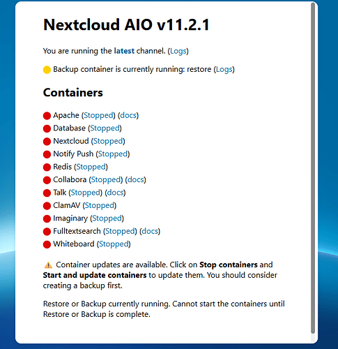

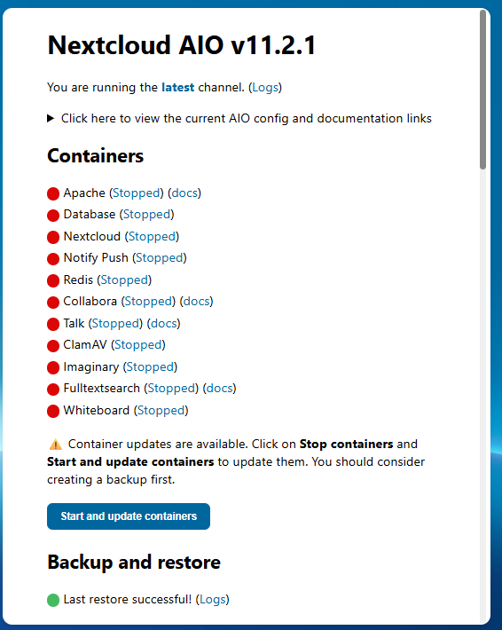

Hi, have you already tried restarting the server and the tried restoring a backup?
Hi, thanks for replying.
Yes I also tried to import the backup on a virtual machine prepared from scratch.
Restore is successful, than the interface asks to update and start the containers and then the issue with the DB begins.
This is the procedure that I tried:
  1. stop the database docker, remove and prune
    $ sudo docker stop nextcloud-aio-database
    $ sudo docker rm nextcloud-aio-database;
    $ sudo docker image prune -af
  2. stop the other dockers and restart the server
  3. select the backup and start restore procedure
  4. update the dockers and start
unfortunately the problem is there:
