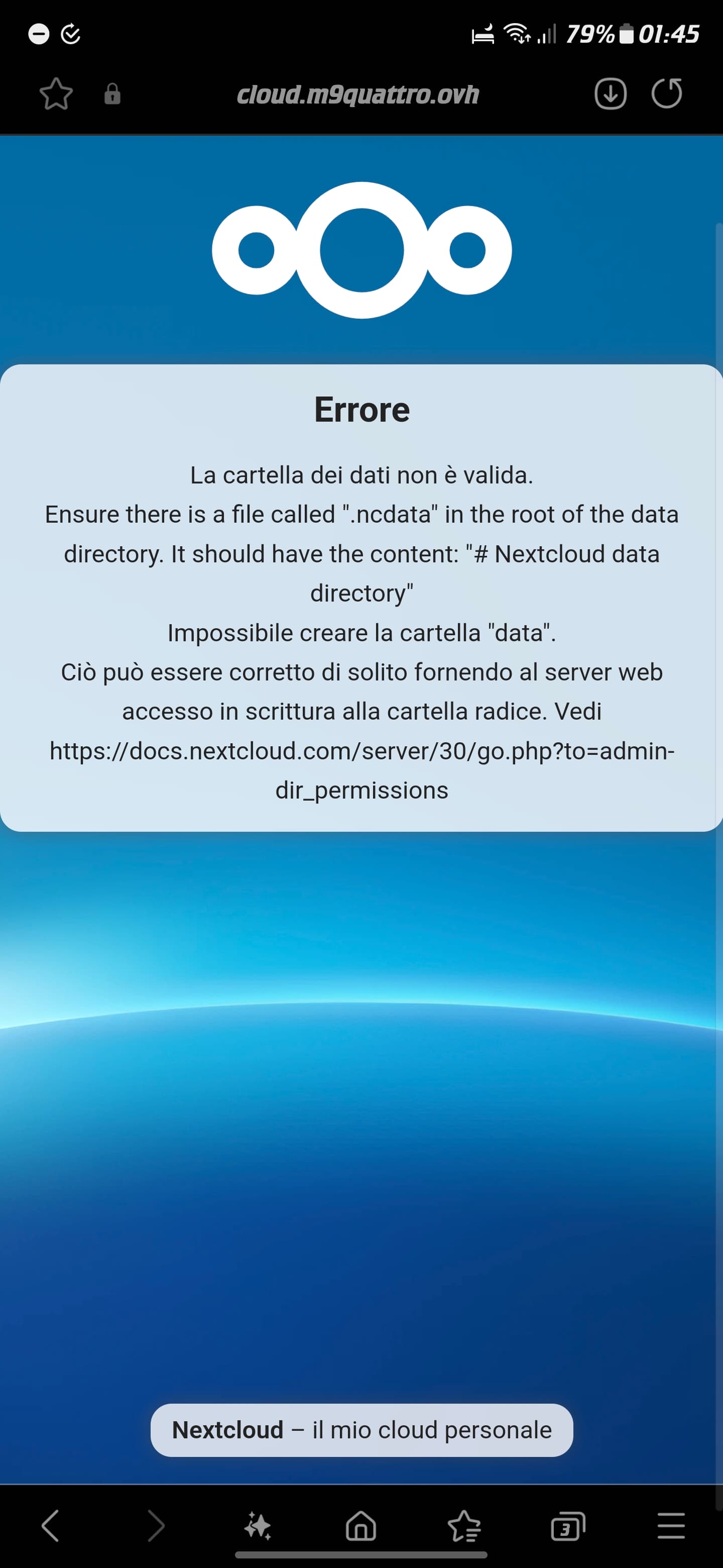

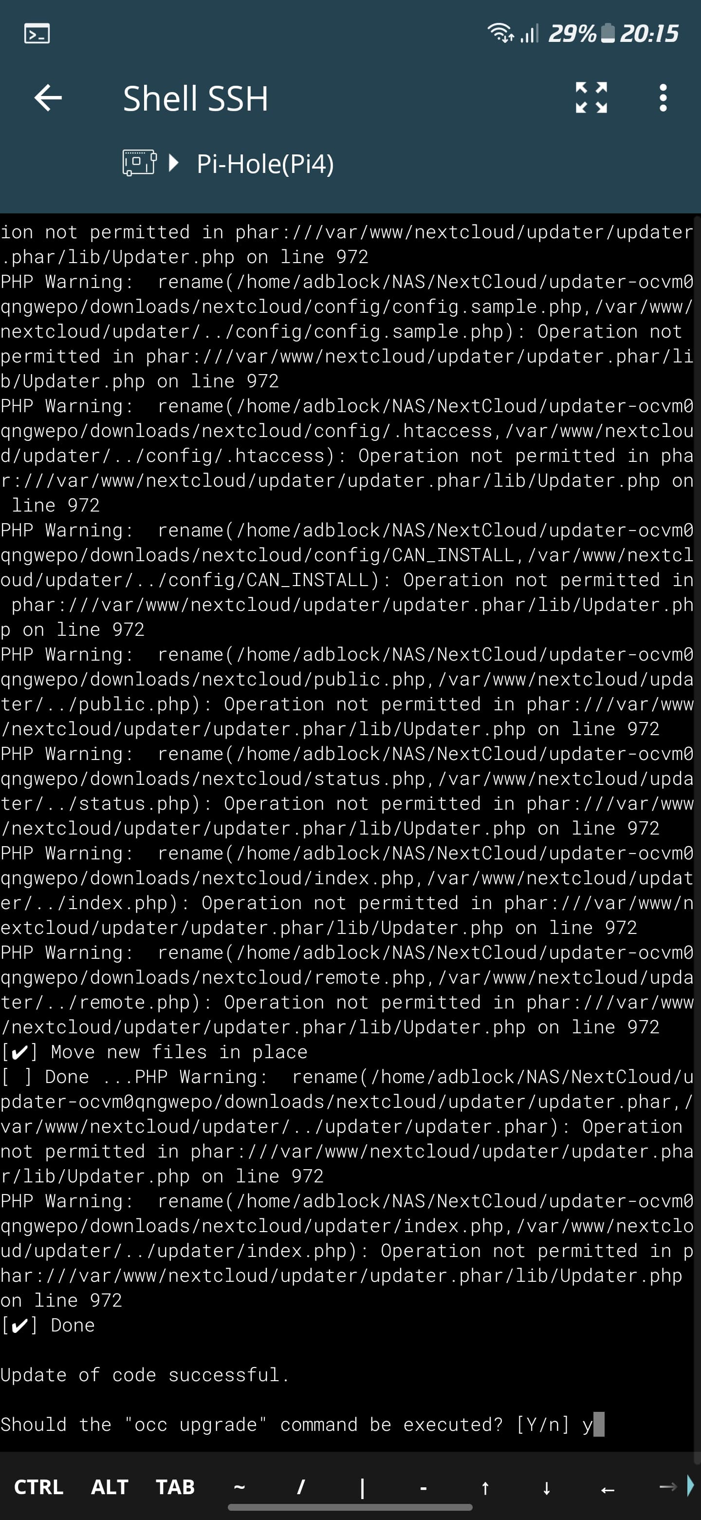

Hi, I have a nextcloud server on a Raspberry Pi4B, while the “data” folder is located externally on a Synology NAS connected to Lan. For a few months I have noticed some errors in the registration log (the one found in the administrator settings) with reference to files in the “data” folder. By delving into the issue and looking for solutions on the web and also with the help of copilot, I understood that the problem was in the permissions of the files and folders on the NAS that do not have the owner www-data, but the Synology user with which I log in. The problem is that from the Raspberry it does not allow me to change the owner as well as the permissions both by connecting it with “nfs” and with “cifs”. Does anyone know if there is some other method that I can try, or is there some configuration of the NAS that cannot be modified? I had found here in the community someone who with a similar configuration had removed the mapping in nfs and had managed to modify the owner and permissions, but then the server would not start anymore. It’s strange because in normal use the files that I upload, download or delete from the cloud, are correctly removed even without ownership of www-data. Is it a problem with how the NAS manages shared folders (maybe with another NAS of another brand it can work), or can I make some software changes that allow me to keep my current hardware configuration?

[index] Errore: The requested uri(/home/adblock/NAS/NextCloud/.ncdata) cannot be processed by the script '/nextcloud/index.php')
GET /home/adblock/NAS/NextCloud/.ncdata

{"reqId":"vAxz5tQnC0IqaQZw62kE","level":3,"time":"2025-02-14T22:26:08+00:00","remoteAddr":"","user":"--","app":"PHP","method":"","url":"--","message":"file_put_contents(/home/adblock/NAS/NextCloud/.ncdata): Failed to open stream: Permission denied at /var/www/nextcloud/lib/private/Updater.php#213","userAgent":"--","version":"30.0.5.1","data":{"app":"PHP"},"id":"67b1c12489f98"}
