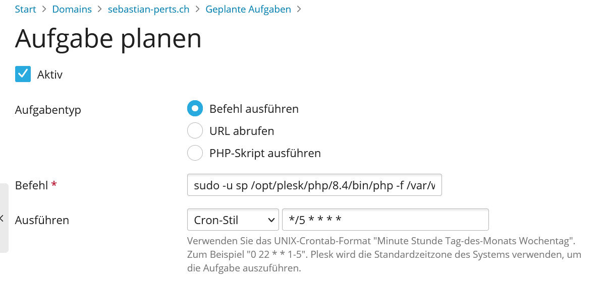

Since an upgrade from NC31 to 32 the adminpanel shows the warning “Some jobs have not been executed since vor einem Monat. Please consider increasing the execution frequency”. The nextcloud instance runs on a hosted virtual server and I have access to it through SSH and Plesk. The cron job calling the cron.php was created using the “Planned Tasks” Feature of Plesk and runs without error according to Plesk and also did work fine this way since it was originally installed. The task is created as using a PHP-script and calls "cloud.mydomain.com/nextcloud/cron.php” with the arguments “php -f -d memory_limit=1024M” and the cron timing */5 * * * *. But NC insists with the warning, that some jobs did not run.
If I deactivate the task in Plesk the Nextcloud shows a different error concerning the cron itself not being executed for x Minutes after a while. So it seems to me that the cron call is executed, but does not do all the things it should do. I have read other threads here (like this one Cronjob with Plesk (once again) ) and there it is written, that the commands one has to use through Plesk are now different. But this commands don’t work in my system, I get the error in Plesk that sudo is not found. If I don’t use sudo in that command, it gives an error to the path “/opt/plesk/php/8.3/php”. I checked that path using ssh, that path is correct and the php file is in it. So I am currently not able to find the reason for this, especially since it worked when it was originally installed with Nextcloud 30.
