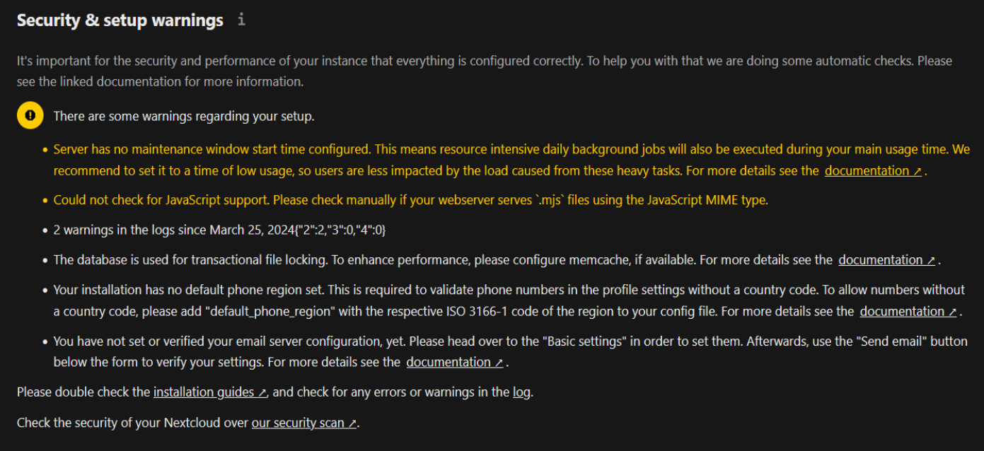

Could not check for JavaScript support. Please check manually if your webserver serves `.mjs` files using the JavaScript MIME type with other errors as per shows in picture

2024/04/01 16:34:50 [error] 538913#538913: *8797 access forbidden by rule, client: 172.24.8.5, server: mission.cac.queensu.ca, request: "HEAD /apps/settings/js/esm-test.mjs HTTP/1.1", host: "example.cac.queensu.ca"

Based on your config and some other hints, it appears you’re using Docker.
This error isn’t saying mjs isn’t working - it’s saying it can’t run the test to determine if it’s working.
The check connects from the Nextcloud Server to itself using https://XXX. Where “XXX” is each the entries in your trusted_domains.
Confirm you can connect from your Nextcloud container (not the underlying host) to one of those URLs. If you search you’ll find curl commands/etc for doing so.
In general, if you’re using one of the Docker images for Nextcloud out there, you’ll have mjs support unless you’re using old web server configs or something.

in other words you connection with http://<serverip:8080> and ´http:´ works and https://<domain> fails. http:<domain> is little surprising as your reverse proxy is supposed to redirect http: to https: which should result in a failure as well… but at first glance It sounds like your reverse proxy HTTPS is not configured in a right way (certificate, firewall, port forwarding etc…)
It looks to me like, within your Nextcloud container, the DNS for mission.cac.queensu.ca resolves to likely the container’s IP address (or maybe 127.0.0.1) rather than what it really resolves to in your external DNS (presumably the IP address of your Nginx reverse proxy on your host). At the moment the check isn’t reaching your proxy to test via https.
