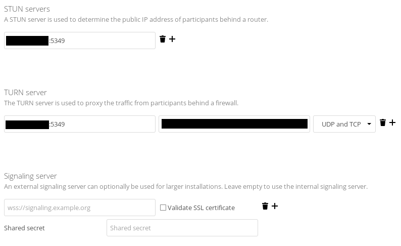

We have a coturn server running in a Docker container on the same host as Nextcloud (which is also in a Docker container). Port 5349 on the coturn container is exposed to the internet via NAT.
Here are our settings. I was hoping someone could point out any obvious mistakes or give troubleshooting tips.

To rule out any Docker weirdness, I set up a standalone coturn server and pointed my NC instance at it. The results are pretty much identical. Any other suggestions? Am I missing something from the config?
I’ve tried UDP only, TCP only, and mixed mode.
