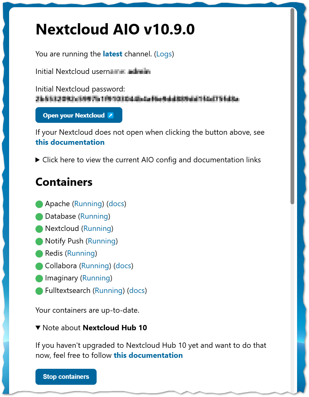

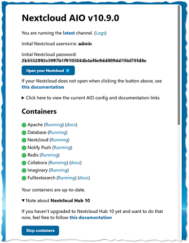

I’ve enabled the Collabora container in the AIO admin UI.

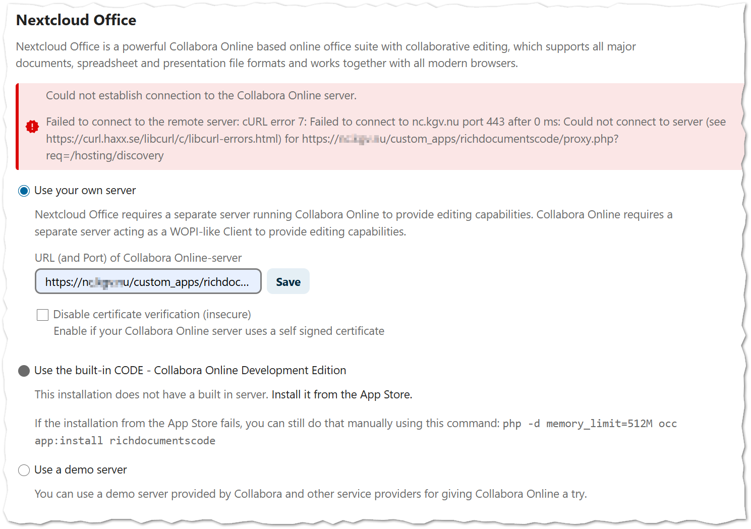

How should I configure the settings under /settings/admin/richdocuments?
As I understand it, I should select “Use your own server”, and not the built-in CODE?

Thanks, I’ll try to check it out. But just simple: Use your own server. Is that the option to select?
Yes it is.

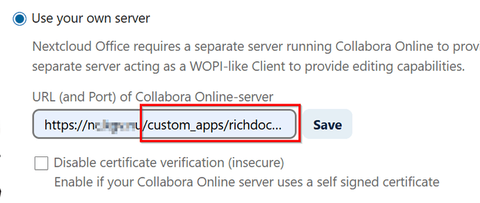

Here are my steps and founding’s:
this field should be only https://nextcloud.examle.com. I don’t know where the “custom_apps/rich…” comes from.
Now the web-editor for documents loads as it shuld!
Thanks for pointing to the correct “Use your own server” - setting, and also the step: curl -vvv https://$NC_DOMAIN:443/hosting/discovery gave me a clue.
