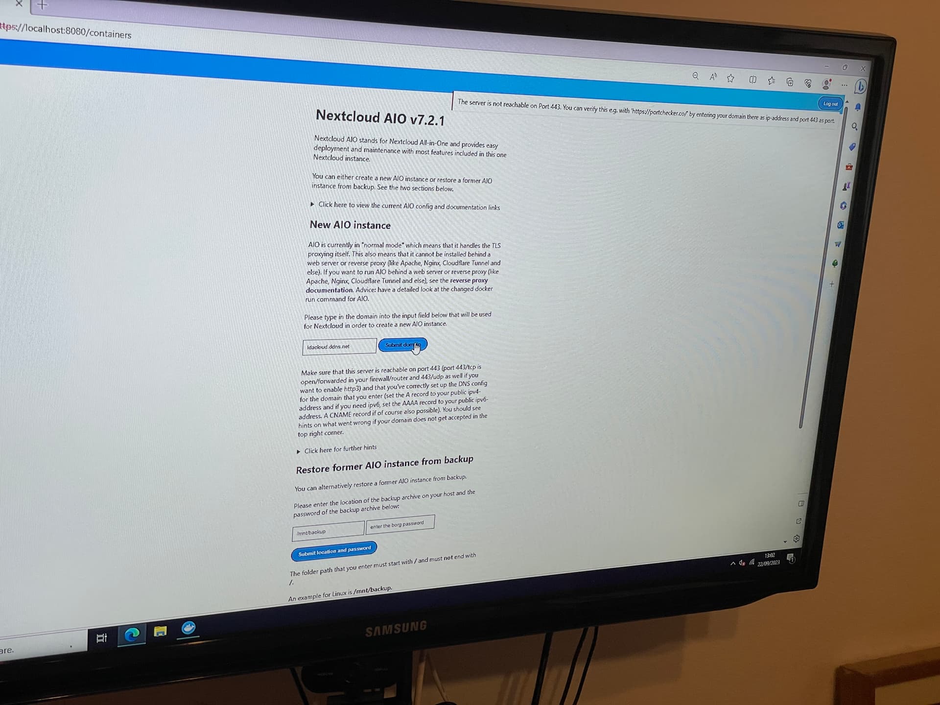

This is the screenshot after entering the value
I assume is
" The Server is not reachable on port 443 . You can verify with https://portchecker.co/ by entering your domain as ip:address and port 443 as port"

So did you already configure port forwarding in your router for port 443?
As you can see if I check with portchecker is open
and there is still the problem

Apparently your dns settings of your domain are not correct. Does it really poojt toward the public ip-address of your home network?
I don’t Know
Before I open the port in the router and after I insert the no-ip adress wit User and password and everything worked fine.
I can do this in nextcloudpi configuration settings.
Here I don’ understand what setting I have to insert.
You only need to insert the domain here. If things are configured corretly, it should accept the domain and continue.
