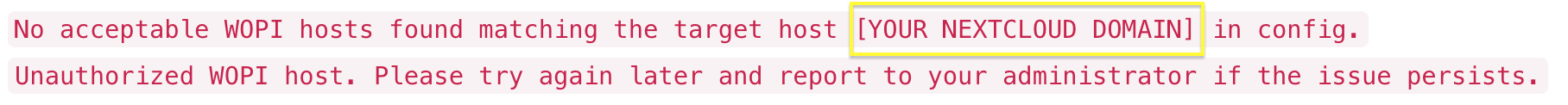

… I install the the Collabora-App, then it say that isn’t the latest version (I tested to install Collabora at Nextcloud v10 without success), then I update the App. But then, the Icon in the left side disappeared. And when I click at an doc or xls it shows me this message:
I don’t know whats a ‘WOPI-Host’?

Just because this is the first unauthorized WOPI-Host hit:
My problem was a space in the domain name when creating the docker container:
‘domain=<space>your-storageshare\\.de’
This domain name ends up in the wopi host definitions in the loolwsd config (with the extra space).
I did not see it for hours on time and wondered, why all matches up perfectly and I still get an error.
Thank you, this was the same by me.
