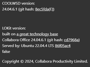

I have 24.04.6.1 and no problem at all:
You should set this entry in your /etc/coolwsd/coolwsd.xml to “true”:
<home_mode>
<enable desc="Enable more configuration options for home users" type="bool" default="false">true</enable>
</home_mode>
… that should make it quiet (at least for me it does)
hth
