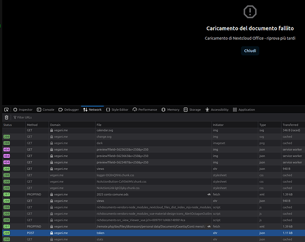

Hello, I still have this issue…
I have NC 31 on Armbian 25.2.2 noble (Ubuntu 24.04)
Installed collabora following instructions from nextcloud website.
Readed this and also this other thread:
https://github.com/nextcloud/all-in-one/discussions/1358
But nothing helped
./occ config:list richdocuments returns

curl -vvv https://vegani.me:443/hosting/discovery returns
* Host vegani.me:443 was resolved.
* IPv6: (none)
* IPv4: 45.151.88.100
*   Trying 45.151.88.100:443...
* Connected to vegani.me (45.151.88.100) port 443

            <!-- MS Excel -->
            <action default="true" ext="xls" name="edit" urlsrc="https://vegani.me/browser/3dc280be53/cool.html?"/>
            <action default="true" ext="xla" name="edit" urlsrc="https://vegani.me/browser/3dc280be53/cool.html?"/>
            <!-- OOXML spreadsheet -->
            <action default="true" ext="xltx" name="view" urlsrc="https://vegani.me/browser/3dc280be53/cool.html?"/>
            <action default="true" ext="xltm" name="view" urlsrc="https://vegani.me/browser/3dc280be53/cool.html?"/>
            <action default="true" ext="xlsx" name="edit" urlsrc="https://vegani.me/browser/3dc280be53/cool.html?"/>
            <action default="true" ext="xlsb" name="edit" urlsrc="https://vegani.me/browser/3dc280be53/cool.html?"/>
            <action default="true" ext="xlsm" name="edit" urlsrc="https://vegani.me/browser/3dc280be53/cool.html?"/>
            <!-- Others -->
            <action default="true" ext="dif" name="edit" urlsrc="https://vegani.me/browser/3dc280be53/cool.html?"/>
            <action default="true" ext="slk" name="edit" urlsrc="https://vegani.me/browser/3dc280be53/cool.html?"/>
            <action default="true" ext="csv" name="edit" urlsrc="https://vegani.me/browser/3dc280be53/cool.html?"/>
            <action default="true" ext="tsv" name="edit" urlsrc="https://vegani.me/browser/3dc280be53/cool.html?"/>
            <action default="true" ext="dbf" name="edit" urlsrc="https://vegani.me/browser/3dc280be53/cool.html?"/>
            <action default="true" ext="wk1" name="view" urlsrc="https://vegani.me/browser/3dc280be53/cool.html?"/>
            <action default="true" ext="wks" name="view" urlsrc="https://vegani.me/browser/3dc280be53/cool.html?"/>
            <action default="true" ext="xlr" name="view" urlsrc="https://vegani.me/browser/3dc280be53/cool.html?"/>
            <action default="true" ext="123" name="view" urlsrc="https://vegani.me/browser/3dc280be53/cool.html?"/>
            <action default="true" ext="qpw" name="view" urlsrc="https://vegani.me/browser/3dc280be53/cool.html?"/>
            <action default="true" ext="wb1" name="view" urlsrc="https://vegani.me/browser/3dc280be53/cool.html?"/>
            <action default="true" ext="wq1" name="view" urlsrc="https://vegani.me/browser/3dc280be53/cool.html?"/>
            <action default="true" ext="wq2" name="view" urlsrc="https://vegani.me/browser/3dc280be53/cool.html?"/>
            <action default="true" ext="gnumeric" name="view" urlsrc="https://vegani.me/browser/3dc280be53/cool.html?"/>
            <action default="true" ext="numbers" name="view" urlsrc="https://vegani.me/browser/3dc280be53/cool.html?"/>
        </app>
        <!-- Impress documents -->
        <app favIconUrl="https://vegani.me/browser/3dc280be53/images/x-office-presentation.svg" name="impress">
            <action default="true" ext="sxi" name="view" urlsrc="https://vegani.me/browser/3dc280be53/cool.html?"/>
            <action default="true" ext="odp" name="edit" urlsrc="https://vegani.me/browser/3dc280be53/cool.html?"/>
            <action default="true" ext="fodp" name="edit" urlsrc="https://vegani.me/browser/3dc280be53/cool.html?"/>
            <!-- Presentation template documents -->
            <action default="true" ext="sti" name="view" urlsrc="https://vegani.me/browser/3dc280be53/cool.html?"/>
            <action default="true" ext="otp" name="view" urlsrc="https://vegani.me/browser/3dc280be53/cool.html?"/>
            <!-- MS PowerPoint -->
            <action default="true" ext="ppt" name="edit" urlsrc="https://vegani.me/browser/3dc280be53/cool.html?"/>
            <action default="true" ext="pot" name="view" urlsrc="https://vegani.me/browser/3dc280be53/cool.html?"/>
            <!-- OOXML presentation -->
            <action default="true" ext="pptx" name="edit" urlsrc="https://vegani.me/browser/3dc280be53/cool.html?"/>
            <action default="true" ext="pptm" name="edit" urlsrc="https://vegani.me/browser/3dc280be53/cool.html?"/>
            <action default="true" ext="potx" name="view" urlsrc="https://vegani.me/browser/3dc280be53/cool.html?"/>
            <action default="true" ext="potm" name="view" urlsrc="https://vegani.me/browser/3dc280be53/cool.html?"/>
            <action default="true" ext="ppsx" name="edit" urlsrc="https://vegani.me/browser/3dc280be53/cool.html?"/>
            <!-- Others -->
            <action default="true" ext="cgm" name="view" urlsrc="https://vegani.me/browser/3dc280be53/cool.html?"/>
            <action default="true" ext="key" name="view" urlsrc="https://vegani.me/browser/3dc280be53/cool.html?"/>
        </app>
        <!-- Draw documents -->
        <app name="draw">
            <action default="true" ext="sxd" name="view" urlsrc="https://vegani.me/browser/3dc280be53/cool.html?"/>
            <action default="true" ext="odg" name="edit" urlsrc="https://vegani.me/browser/3dc280be53/cool.html?"/>
            <action default="true" ext="fodg" name="edit" urlsrc="https://vegani.me/browser/3dc280be53/cool.html?"/>
            <!-- Drawing template documents -->
            <action default="true" ext="std" name="view" urlsrc="https://vegani.me/browser/3dc280be53/cool.html?"/>
            <action default="true" ext="otg" name="view" urlsrc="https://vegani.me/browser/3dc280be53/cool.html?"/>
            <!-- Others -->
            <action ext="svg" name="view" urlsrc="https://vegani.me/browser/3dc280be53/cool.html?"/>
            <action default="true" ext="dxf" name="view" urlsrc="https://vegani.me/browser/3dc280be53/cool.html?"/>
            <action default="true" ext="emf" name="view" urlsrc="https://vegani.me/browser/3dc280be53/cool.html?"/>
            <action default="true" ext="wmf" name="view" urlsrc="https://vegani.me/browser/3dc280be53/cool.html?"/>
            <action default="true" ext="cdr" name="view" urlsrc="https://vegani.me/browser/3dc280be53/cool.html?"/>
            <action default="true" ext="vsd" name="view" urlsrc="https://vegani.me/browser/3dc280be53/cool.html?"/>
            <action default="true" ext="vsdx" name="view" urlsrc="https://vegani.me/browser/3dc280be53/cool.html?"/>
            <action default="true" ext="vss" name="view" urlsrc="https://vegani.me/browser/3dc280be53/cool.html?"/>
            <action default="true" ext="pub" name="view" urlsrc="https://vegani.me/browser/3dc280be53/cool.html?"/>
            <action default="true" ext="p65" name="view" urlsrc="https://vegani.me/browser/3dc280be53/cool.html?"/>
            <action default="true" ext="wpg" name="view" urlsrc="https://vegani.me/browser/3dc280be53/cool.html?"/>
            <action default="true" ext="fh" name="view" urlsrc="https://vegani.me/browser/3dc280be53/cool.html?"/>
            <action ext="bmp" name="view" urlsrc="https://vegani.me/browser/3dc280be53/cool.html?"/>
            <action ext="png" name="view" urlsrc="https://vegani.me/browser/3dc280be53/cool.html?"/>
            <action ext="gif" name="view" urlsrc="https://vegani.me/browser/3dc280be53/cool.html?"/>
            <action ext="tiff" name="view" urlsrc="https://vegani.me/browser/3dc280be53/cool.html?"/>
            <action ext="jpg" name="view" urlsrc="https://vegani.me/browser/3dc280be53/cool.html?"/>
            <action ext="jpeg" name="view" urlsrc="https://vegani.me/browser/3dc280be53/cool.html?"/>
            <action ext="pdf" name="view_comment" urlsrc="https://vegani.me/browser/3dc280be53/cool.html?"/>
        </app>
        <!-- Math documents -->
        <!-- In fact Math documents are not supported at all.
             See: https://bugs.documentfoundation.org/show_bug.cgi?id=97006
        <app name="math">
            <action name="view" default="true" ext="sxm"/>
            <action name="edit" default="true" ext="odf"/>
        </app>
        <!-- Legacy MIME-type actions (compatibility) -->
        <app name="image/svg+xml">
            <action ext="" name="view" urlsrc="https://vegani.me/browser/3dc280be53/cool.html?"/>
        </app>
        <app name="application/vnd.ms-powerpoint">
            <action default="true" ext="" name="edit" urlsrc="https://vegani.me/browser/3dc280be53/cool.html?"/>
        </app>
        <app name="application/vnd.ms-excel">
        </app>
        <!-- Writer documents -->
        <app name="application/vnd.sun.xml.writer">
            <action default="true" ext="" name="view" urlsrc="https://vegani.me/browser/3dc280be53/cool.html?"/>
        </app>
        <app name="application/vnd.oasis.opendocument.text">
        </app>
        <app name="application/vnd.oasis.opendocument.text-flat-xml">
        </app>
        <!-- Calc documents -->
        <app name="application/vnd.sun.xml.calc">
        </app>
        <app name="application/vnd.oasis.opendocument.spreadsheet">
        </app>
        <app name="application/vnd.oasis.opendocument.spreadsheet-flat-xml">
        </app>
        <app name="application/vnd.sun.xml.impress">
        </app>
        <app name="application/vnd.oasis.opendocument.presentation">
        </app>
        <app name="application/vnd.oasis.opendocument.presentation-flat-xml">
        </app>
        <app name="application/vnd.sun.xml.draw">
        </app>
        <app name="application/vnd.oasis.opendocument.graphics">
        </app>
        <app name="application/vnd.oasis.opendocument.graphics-flat-xml">
        </app>
        <!-- Chart documents -->
        <app name="application/vnd.oasis.opendocument.chart">
        </app>
        <!-- Text master documents -->
        <app name="application/vnd.sun.xml.writer.global">
        </app>
        <app name="application/vnd.oasis.opendocument.text-master">
        </app>
        <app name="application/vnd.sun.xml.math">
            <action name="view" default="true" ext=""/>
        </app>
        <app name="application/vnd.oasis.opendocument.formula">
            <action name="edit" default="true" ext=""/>
        </app>
        <!-- Text template documents -->
        <app name="application/vnd.sun.xml.writer.template">
        </app>
        <app name="application/vnd.oasis.opendocument.text-template">
        </app>
        <!-- Writer master document templates -->
        <app name="application/vnd.oasis.opendocument.text-master-template">
        </app>
        <!-- Spreadsheet template documents -->
        <app name="application/vnd.sun.xml.calc.template">
        </app>
        <app name="application/vnd.oasis.opendocument.spreadsheet-template">
        </app>
        <app name="application/vnd.sun.xml.impress.template">
        </app>
        <app name="application/vnd.oasis.opendocument.presentation-template">
        </app>
        <app name="application/vnd.sun.xml.draw.template">
        </app>
        <app name="application/vnd.oasis.opendocument.graphics-template">
        </app>
        <!-- MS Word -->
        <app name="application/msword">
        </app>
        </app>
        <!-- MS Excel -->
        </app>
        </app>
        <!-- OOXML wordprocessing -->
        <app name="application/vnd.openxmlformats-officedocument.wordprocessingml.document">
        </app>
        <app name="application/vnd.ms-word.document.macroEnabled.12">
        </app>
        <app name="application/vnd.openxmlformats-officedocument.wordprocessingml.template">
        </app>
        <app name="application/vnd.ms-word.template.macroEnabled.12">
        </app>
        <app name="application/vnd.openxmlformats-officedocument.spreadsheetml.template">
        </app>
        <app name="application/vnd.ms-excel.template.macroEnabled.12">
        </app>
        <app name="application/vnd.openxmlformats-officedocument.spreadsheetml.sheet">
        </app>
        <app name="application/vnd.ms-excel.sheet.binary.macroEnabled.12">
        </app>
        <app name="application/vnd.ms-excel.sheet.macroEnabled.12">

looking at the inspector in the browser,
I see that websocket connection :
wss://vegani.me/cool/.....&compat=/ws
is failing with 404.
I don’t know what’s wrong :frowning:
I also tried setting
wopi-allowlist to 0.0.0.0 but no luck either.
Thanks
Danilo

Thank you very much, unfortunately the issue remains.

it should be something related to the websocket because the firefox inspector gives me 404 on websocket connection.

I kept advantage of the upgrade to replace my coolwsd.xml configuration and re-configure everything from scratch following the guide:
Now the error changed, It just waits for a while and then say “try again later”
