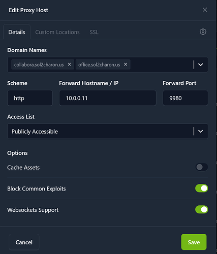

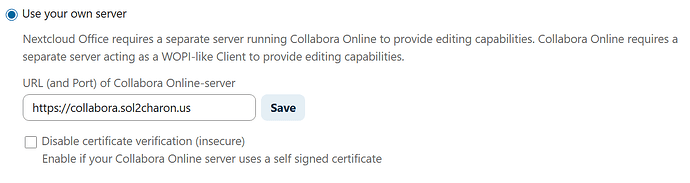

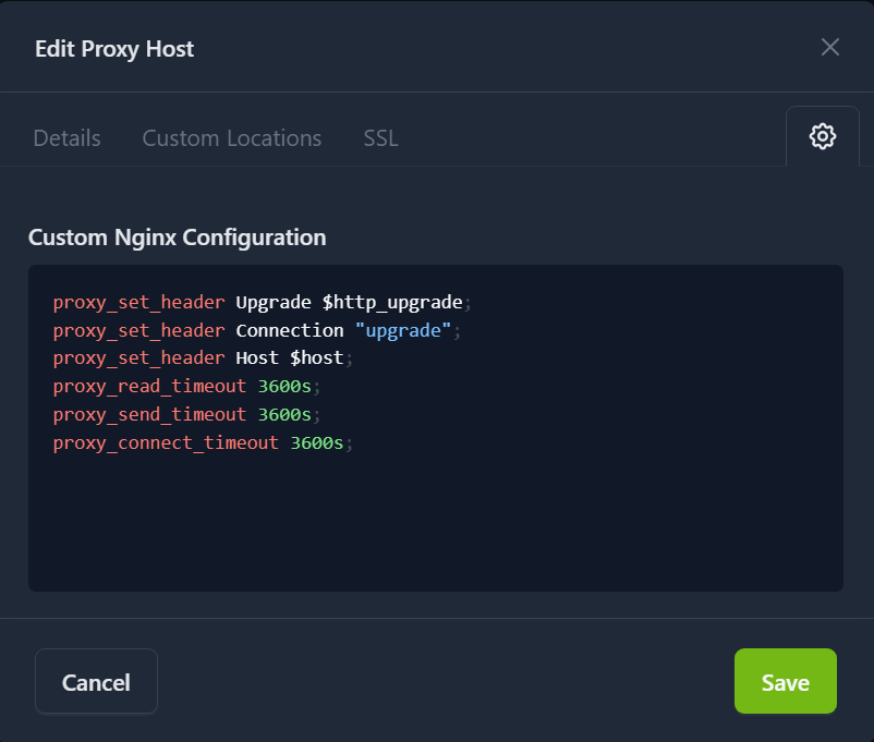

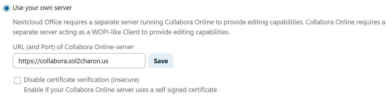

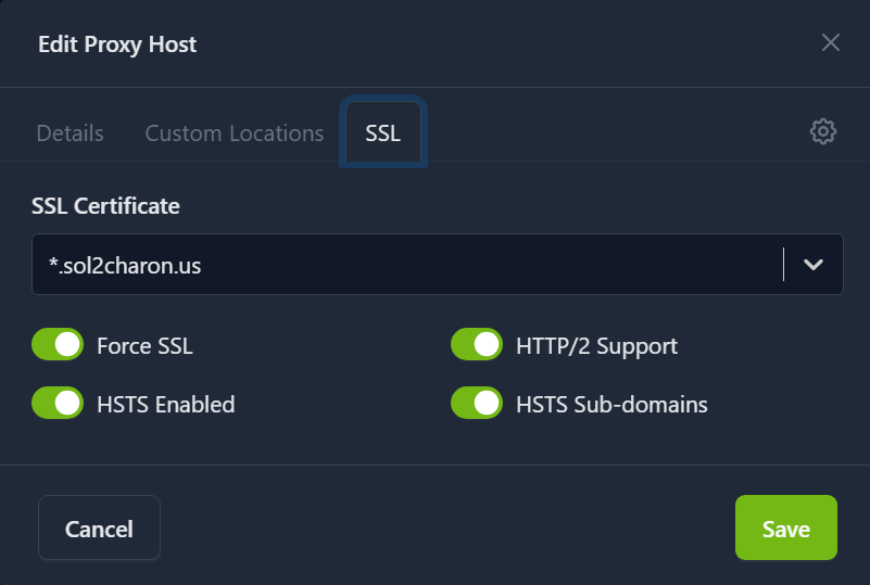

I have been slowly attempting to resolve all of the installation issues, this is the biggest. I have collabora installed in a separate container on docker BUT using the same nextcloud_network. Collabora is returning OK in the browser when I reach it using https://collabora.sol2charon.us. When I go to the User > Administration Settings > Administration > Office I get

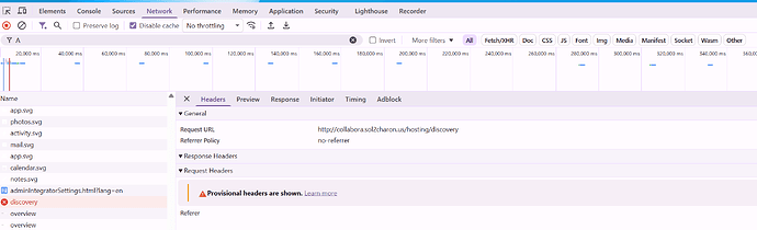

Your browser has been unable to connect to the Collabora server: http://collabora.sol2charon.us
This URL is determined on the Collabora server either from the configured URL or the server_name parameter in coolwsd.xml.
Note that it is complaining about http:// instead of the https:// that is clearly in the URL.
I have updated the coolwsd.xml adding the server_name and the network 172.27.0.0 to the lok_allow and post_allow. But nothing I do seems to resolve the connectivity issue.

I am certain this is something very simple to correct but AI has not been able to get me there. I have also noticed that for some reason discovery is attempting to use http instead of https. Obviously not being able to use the collabora server means that I cannot open any docx etc.
