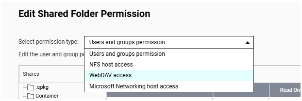

Off course, WebDAV it is.
the “WebDAV permission” is the Key!
not “ Shared folder permission
Then in shared folders : make a Folder and change the permissions.

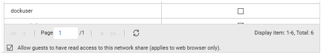

Golden Tip for all QNAP users !!!
YOU NEED TO APLY THE
“Allow guest to have …..”
Otherwise it is not possible to connect (bug QNAP)
