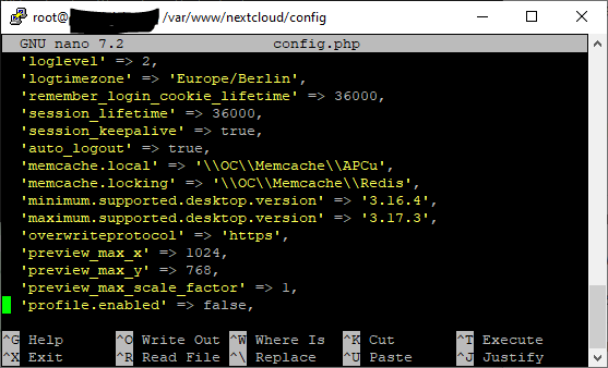

Just a wild guess. Do you perhaps have the following line in config.php…?
'maximum.supported.desktop.version' => '3.17.3'
If so, either delete it or set it to a suitable value.

truly, yes! Don’t know why its there written.
The Client doesn’t get this version restrictions from the server and starts the update to version 4.0.1. With the new version no connection ist established.
Thanks alot!
Did you perhaps use the installation instructions or installation script from C-Rieger? If so, this is why: Aktualisierungen und Neuigkeiten - Carsten Rieger And the reason for this is again the issues with 4.0.0.
If you didn’t use the C-Rieger script/instructions, I have no idea why it was there. As far as I know, this line is not added by default, and the default according to config.sample.php is…
'maximum.supported.desktop.version' => ‘99.99.99’,
https://github.com/nextcloud/server/blob/815338cdc0fb6748cace9e5c861e606e55fe40af/config/config.sample.php#L2324
Indeed, I did :smiley:
I had issues updating to a newer Ubuntu version, mariadb and also liked to make my media in my home network via dlna (using external files in NC) available. So I restructured my files and ended up, after working with NC for years now, using the script of C-Rieger with a plain new installation.
I’ll have a eye on the verion 4.x of the windows client and wait a couple of subversions until I go for the 99.99.99.
