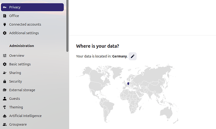

Are you sure that this ā€œPrivacy → Where is your dataā€ setting actually does anything functional on the server, apart from simply showing users where the admin claims the server is located?
I’ve actually been wondering about the maintenance_window_start option for a while. Does it really always use UTC (as the documentation suggests), or does this depend on other factors, such as the system time zone, the time zone setting in php.ini or maybe even the ā€œWhere is your dataā€ setting"?
I’d also be interested to know which exact jobs are affected by this setting (yeah I know, this could probably be found in the code, but I’m not a coder), whether they’re logged and, if so, at which log level. This would allow me to determine if and when they are actually executed.
nope i’m not sure, but bar having any other possibility specifying where the server is located, this seems plausible?
I’ve not discovered anything contrary…
neither am I :nerd_face:
Me neither, but to be honest, I’ve also never really been able to confirm that it actually works that way, and OP’s post made me a bit unsure again.
The question wasn’t directed only at you anyway, but it would be nice if somoene could provide some insight.
It’s mostly out of curiosity. For us, it doesn’t really make much of a difference anyway. Like you, I live in the UTC+1 timezone (UTC+2 during summer), and I’ve configured it to 0. So whether those maintenance jobs run at midnight, 1 a.m., or 2 a.m. doesn’t matter much to me, but it would still be interesting to know. :grinning_face_with_smiling_eyes:
