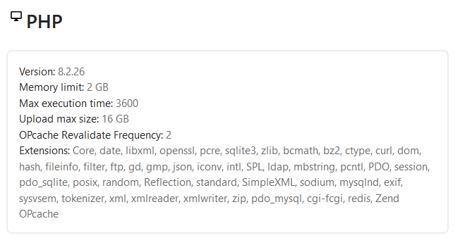

I want to change the values of “upload_max_filesize” and “post_max_size” in php.ini
Nextcloud Snap is quite limited. I have searched again. There seems to be no way to change the values you mentioned.
what is wrong with the default settings?
grafik
Files larger than 1GB do not work
please be more clear, what does not work?
default instances allow uploading and downloading files of any size
Sorry. I tried to upload a 1GB file on Nextcloud, it didn’t work. Searching on the web, I found this :

please note, the snap does not throttle data transfer in any way! although some folks like @devnull still believe that the snap is limited, this is not so! the config file may be edited as you please, see PHP configuration options
we all know that @devnull is no fan of the snap… :stuck_out_tongue_winking_eye:
if you are experiencing throttling somewhere it will most certainly be some network issue, possibly reverse proxy or your ISP maybe even some firewall issue or local DNS or something.

The probleme came from SWAP space.
I increased the size.
It’s working now.
