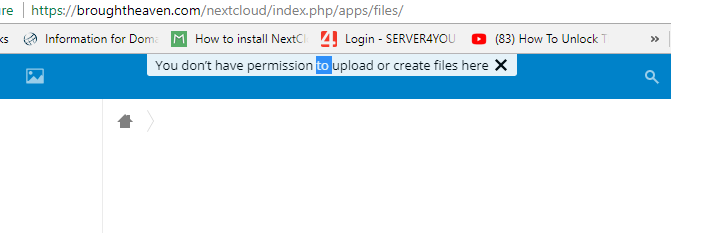

CentOS 7 and CWPpro. WebDAV broken No memory cache has been configured. PHP OPcache is not properly configured
I can not get around this issue I am running on a vServer with
CentOS 7 and CWPpro
I had made a fresh installation yesterday of the CentOS and the CWPpro was installed by support stuff from centos-webpanel.com
so there will not be any issues if i have installed it my self.
I use the account i have created with my CWPpro for to host a domain
https://broughtheaven.com/nextcloud/
this image is when i log in the main page stays on loading all the time
cant upload any thing i do not even have a plus button for creating folders
if i go to gallery and click on plus symbol it looks ok I make attempt to upload
it shows that is uploading but again nothing
this is the error i get
Please Help me I cant take it any longer i think i am going crazy here…
