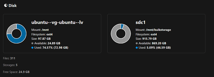

I’ve gotta be honest, I’m totally new to all this. How would I go about checking/changing those? Also ARM is not writing to those drives. It’s weird, in nextcloud its showing as being on the external storage but when I look at disk space it’s all taken up on the main drive

I was forgetting about how mounting worked and did it at runtime, now it’s added the drive to fstab and it showed as a drive in the system section of nextcloud. I still couldn’t move files onto that drive via the web interface so I tried removing it from the external storage section and adding it back, and now all the folders are empty and theres a lost+found folder that says pending and that the drive couldn’t be accessed on it. I had no important data on it so I’m fine to wipe and start again, I’ve waited a couple hours and nothing’s changed

so could you answer those questions and give us insight into your AIO stack to see how that file system is mounted? especially the volumes section.

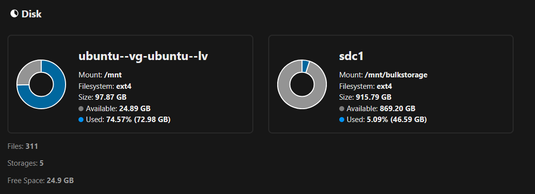

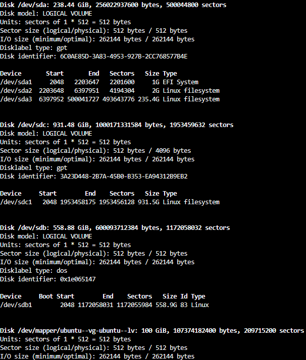

How would I go about checking those? As I said I’m very new. I’ve attached a couple pictures in case that provides any useful info
