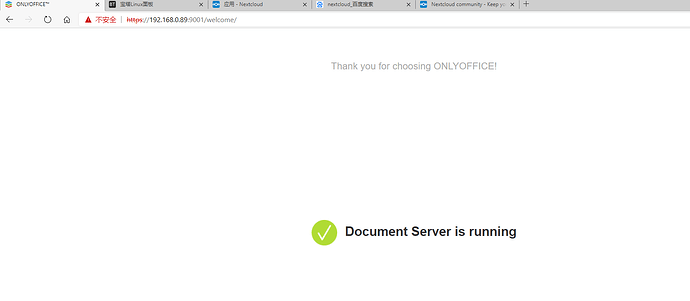

I have installed the only office server in centos 6 by docker. And i believe i installed it right, because i can visit the only office server through https。here is successful result.

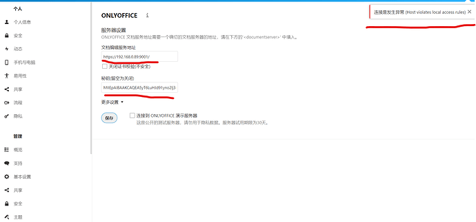

2. and here is my nextcloud configuration
3. so what cause the error?

Did you add the external & internal URL of your OO server in the nextcloud config file as « trusted server » ?
It could help, see here : Nextcloud & Onlyoffice via Docker - can't connect on the same server
Also, try to check the checkbox under the first IP adress field on the OO setting page in Nextcloud
yeah, I take your playbook, but the error still remains.
i will show you all my configuration,ok?
config.php
<?php $CONFIG = array ( 'instanceid' => 'oc9rw2kusdgd', 'passwordsalt' => 'YnuL8oRvuft6QNfdy4wviWrNwFzOuQ', 'secret' => '9G15xsfzRG2jcafND5L7PorIzb5+KZjVrM1aI1W/w+zCyz/8', 'trusted_domains' => array ( 0 => '192.168.0.89', 1 => preg_match('/cli/i',php_sapi_name())?'127.0.0.1':$_SERVER['SERVER_NAME'], ), 'datadirectory' => '/www/wwwroot/192.168.0.89/data', 'dbtype' => 'sqlite3', 'version' => '20.0.0.9', 'overwrite.cli.url' => 'http://192.168.0.89', 'installed' => true, 'appstoreenabled' => true, 'appstoreurl' => 'https://www.orcy.net/ncapps/v1/', 'app_install_overwrite' => array ( 0 => 'richdocuments', 1 => 'calendar', 2 => 'contacts', ), 'allow_local_remote_servers' => true, 'onlyoffice' => array ( 'verify_peer_off' => TRUE, ), 'jwt_header' => 'AuthorizationJwt', );
