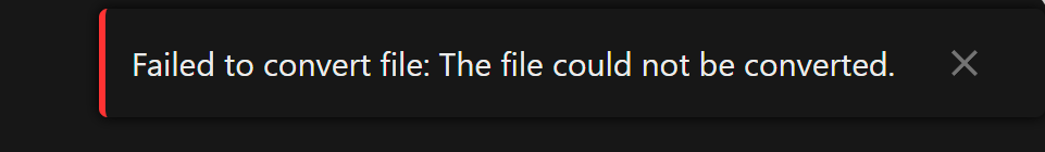

Specifically, I have ‘Nextcloud Office’ with ‘Collabora Online - Built-in CODE Server’. Save-As operation for documents does not work. This includes not just PDFs, but also save-as to .txt, .rtf, etc.
Error ‘Failed to convert file: The file could not be converted.’ is returned.
Here’s what log file return when attempting to save-as to pdf:
richdocuments ClientExceptionClient error: POST https://test.com/apps/richdocumentscode/proxy.php?req=/cool/convert-to/pdf resulted in a 403 Forbidden responseFailed to convert preview: Client error: POST https://test.com/apps/richdocumentscode/proxy.php?req=/cool/convert-to/pdf resulted in a 403 Forbidden response

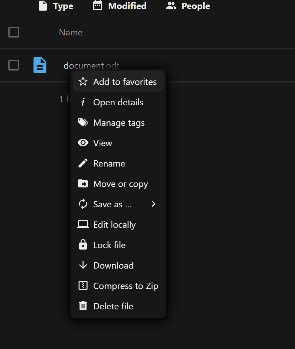

Yet PDFs (and other Save-As formats) are still not generated (from right-click context menu from the Files app).

files ClientExceptionClient error: POST https://office.test.com/cool/convert-to/pdf resulted in a 403 Forbidden response
richdocument ClientExceptionClient error: POST https://office.test.com/cool/convert-to/pdf resulted in a 403 Forbidden response

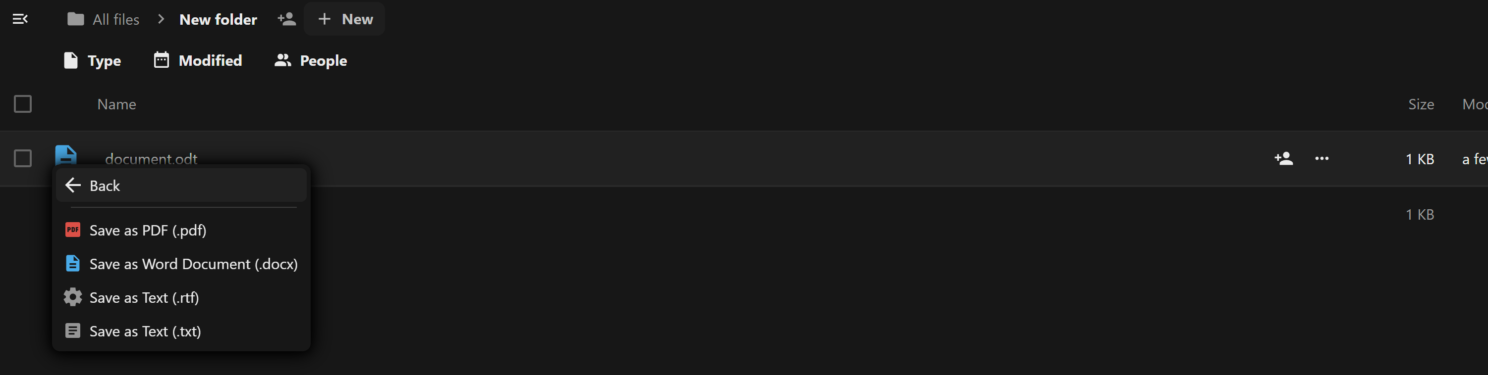

I’m referring to this command - Save-As command on a document from Files app. Neither of these formats conversions work.

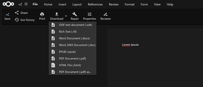

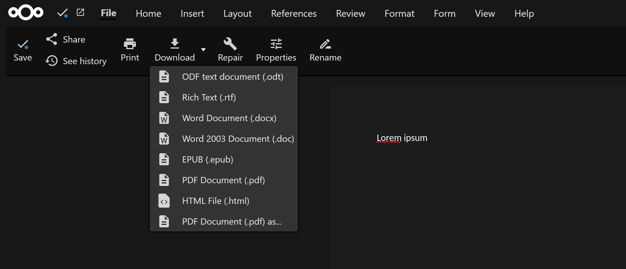

However, when document is opened in Collabora, FIle > Download > works. But this downloads PDF to local file system.

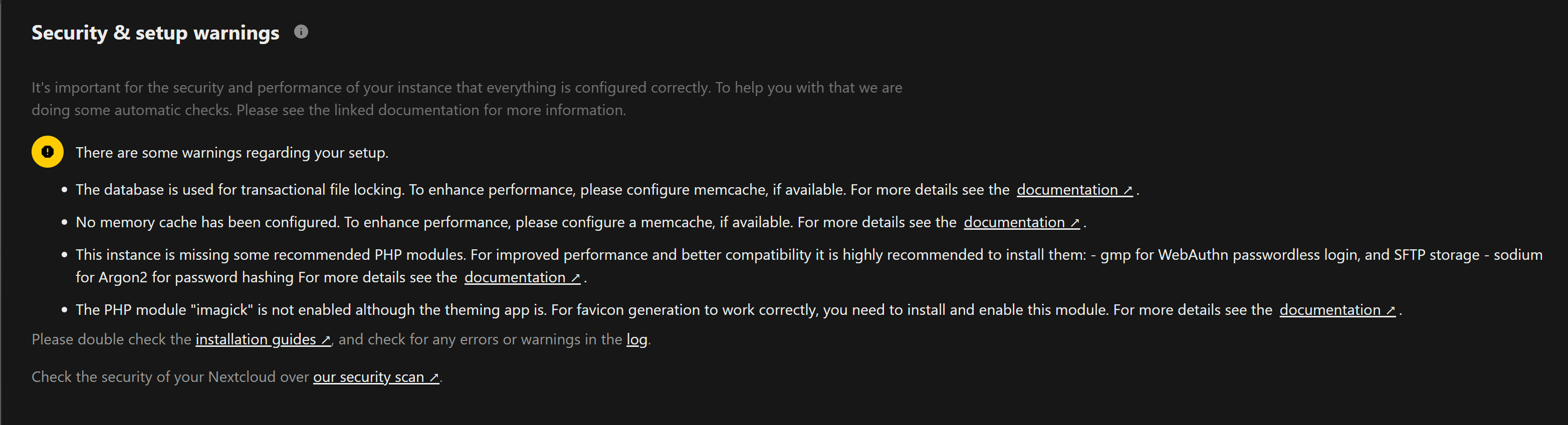

This is my Administration > Overview check window
@U284818 As previously stated the Save as PDF is not a standard option of Nextcloud so you have to find out which app you installed that create that entry. It’s the only way to be able to find perhaps a solution !
You also need to fix all errors listed in the Administration menu.
Last point you can export in PDF straight from Collabora Online: File → Export as PDF and the PDF is by default created in same directory as the file opened in Collabora :wink:
