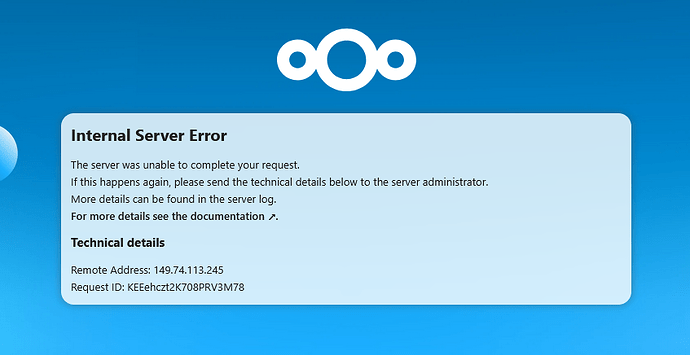

Can't access Nextcloud affter update to 32.0.3.2 - All containers in green - Internal Server Error
    • 32.0.3.2
    • Ubuntu 22.04.5
    • 2.4.66
    • latest container
    • unk
    • yes
    • today after clicking on update master-container
    • AIO
After updating the master-container and the rest of containers all are in green status, but when I try to accedd the Nextclpud webpage I receive this error:
  1. Update master container
  2. Update rest of containers
  3. Try to access main page

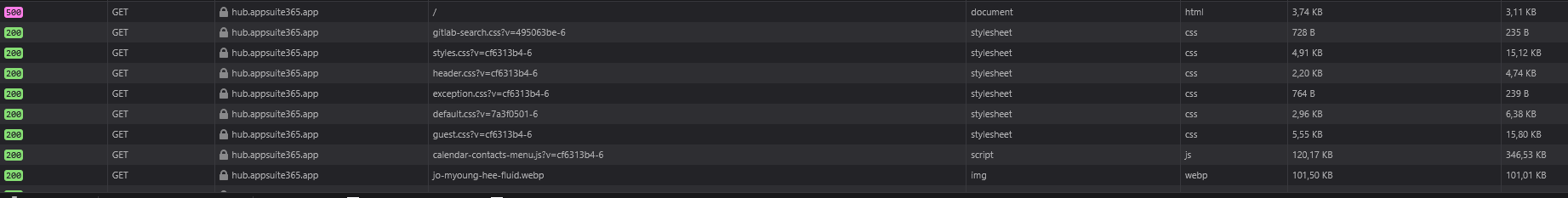

{"reqId":"soyU9FEmL8ZALfQUo60X","level":3,"time":"2026-01-02T13:22:13+00:00","remoteAddr":"127.0.0.1","user":"--","app":"PHP","method":"GET","url":"/ocs/v2.php/cloud/capabilities","message":"Error: Call to undefined method OCA\\Files_Snapshots\\AppInfo\\Application::registerRoutes() at /var/www/html/custom_apps/files_snapshots/appinfo/routes.php#27","userAgent":"nextcloud-spreed-signaling/2.0.4~docker","version":"32.0.3.2","data":{"app":"PHP"}}
{"reqId":"ioCVSTgbTml5bReMuy3E","level":3,"time":"2026-01-02T13:23:14+00:00","remoteAddr":"127.0.0.1","user":"--","app":"PHP","method":"GET","url":"/ocs/v2.php/cloud/capabilities","message":"Error: Call to undefined method OCA\\Files_Snapshots\\AppInfo\\Application::registerRoutes() at /var/www/html/custom_apps/files_snapshots/appinfo/routes.php#27","userAgent":"nextcloud-spreed-signaling/2.0.4~docker","version":"32.0.3.2","data":{"app":"PHP"}}
{"reqId":"wOpk38pPGqLLNJ4s5BPc","level":3,"time":"2026-01-02T13:23:14+00:00","remoteAddr":"127.0.0.1","user":"--","app":"PHP","method":"GET","url":"/ocs/v2.php/cloud/capabilities","message":"Error: Call to undefined method OCA\\Files_Snapshots\\AppInfo\\Application::registerRoutes() at /var/www/html/custom_apps/files_snapshots/appinfo/routes.php#27","userAgent":"nextcloud-spreed-signaling/2.0.4~docker","version":"32.0.3.2","data":{"app":"PHP"}}
{"reqId":"HAACeJc7NsDoKwpyPbMQ","level":3,"time":"2026-01-02T13:24:16+00:00","remoteAddr":"127.0.0.1","user":"--","app":"PHP","method":"GET","url":"/ocs/v2.php/cloud/capabilities","message":"Error: Call to undefined method OCA\\Files_Snapshots\\AppInfo\\Application::registerRoutes() at /var/www/html/custom_apps/files_snapshots/appinfo/routes.php#27","userAgent":"nextcloud-spreed-signaling/2.0.4~docker","version":"32.0.3.2","data":{"app":"PHP"}}
{"reqId":"HUIvPjZlv9c72tulJtRq","level":3,"time":"2026-01-02T13:24:16+00:00","remoteAddr":"127.0.0.1","user":"--","app":"PHP","method":"GET","url":"/ocs/v2.php/cloud/capabilities","message":"Error: Call to undefined method OCA\\Files_Snapshots\\AppInfo\\Application::registerRoutes() at /var/www/html/custom_apps/files_snapshots/appinfo/routes.php#27","userAgent":"nextcloud-spreed-signaling/2.0.4~docker","version":"32.0.3.2","data":{"app":"PHP"}}
{"reqId":"u0gop7HnxSo2z3TbmtPE","level":3,"time":"2026-01-02T13:25:17+00:00","remoteAddr":"127.0.0.1","user":"--","app":"PHP","method":"GET","url":"/ocs/v2.php/cloud/capabilities","message":"Error: Call to undefined method OCA\\Files_Snapshots\\AppInfo\\Application::registerRoutes() at /var/www/html/custom_apps/files_snapshots/appinfo/routes.php#27","userAgent":"nextcloud-spreed-signaling/2.0.4~docker","version":"32.0.3.2","data":{"app":"PHP"}}
{"reqId":"c6T9F9MlJBvbqCOLOvBa","level":3,"time":"2026-01-02T13:25:17+00:00","remoteAddr":"127.0.0.1","user":"--","app":"PHP","method":"GET","url":"/ocs/v2.php/cloud/capabilities","message":"Error: Call to undefined method OCA\\Files_Snapshots\\AppInfo\\Application::registerRoutes() at /var/www/html/custom_apps/files_snapshots/appinfo/routes.php#27","userAgent":"nextcloud-spreed-signaling/2.0.4~docker","version":"32.0.3.2","data":{"app":"PHP"}}
{"reqId":"vVDHDk7zgkRTs6D9QmGo","level":3,"time":"2026-01-02T13:26:18+00:00","remoteAddr":"127.0.0.1","user":"--","app":"PHP","method":"GET","url":"/ocs/v2.php/cloud/capabilities","message":"Error: Call to undefined method OCA\\Files_Snapshots\\AppInfo\\Application::registerRoutes() at /var/www/html/custom_apps/files_snapshots/appinfo/routes.php#27","userAgent":"nextcloud-spreed-signaling/2.0.4~docker","version":"32.0.3.2","data":{"app":"PHP"}}
{"reqId":"ArynTrllz6A60AGEDjxp","level":3,"time":"2026-01-02T13:26:18+00:00","remoteAddr":"127.0.0.1","user":"--","app":"PHP","method":"GET","url":"/ocs/v2.php/cloud/capabilities","message":"Error: Call to undefined method OCA\\Files_Snapshots\\AppInfo\\Application::registerRoutes() at /var/www/html/custom_apps/files_snapshots/appinfo/routes.php#27","userAgent":"nextcloud-spreed-signaling/2.0.4~docker","version":"32.0.3.2","data":{"app":"PHP"}}
{"reqId":"0HMuKrUbajOns1kR6q6E","level":3,"time":"2026-01-02T13:26:32+00:00","remoteAddr":"149.74.113.245","user":"admin","app":"index","method":"GET","url":"/","message":"Call to undefined method OCA\\Files_Snapshots\\AppInfo\\Application::registerRoutes()","userAgent":"Mozilla/5.0 (Windows NT 10.0; Win64; x64; rv:146.0) Gecko/20100101 Firefox/146.0","version":"32.0.3.2","exception":{"Exception":"Error","Message":"Call to undefined method OCA\\Files_Snapshots\\AppInfo\\Application::registerRoutes()","Code":0,"Trace":[{"file":"/var/www/html/lib/private/Route/Router.php","line":524,"function":"include"},{"file":"/var/www/html/lib/private/Route/CachingRouter.php","line":146,"function":"requireRouteFile","class":"OC\\Route\\Router","type":"->","args":["/var/www/html/custom_apps/files_snapshots/appinfo/routes.php","files_snapshots"]},{"file":"/var/www/html/lib/private/Route/Router.php","line":164,"function":"requireRouteFile","class":"OC\\Route\\CachingRouter","type":"->","args":["/var/www/html/custom_apps/files_snapshots/appinfo/routes.php","files_snapshots"]},{"file":"/var/www/html/lib/private/Route/Router.php","line":277,"function":"loadRoutes","class":"OC\\Route\\Router","type":"->","args":[]},{"file":"/var/www/html/lib/private/Route/CachingRouter.php","line":77,"function":"findMatchingRoute","class":"OC\\Route\\Router","type":"->","args":[""]},{"file":"/var/www/html/lib/private/Route/Router.php","line":313,"function":"findMatchingRoute","class":"OC\\Route\\CachingRouter","type":"->","args":[""]},{"file":"/var/www/html/lib/base.php","line":1061,"function":"match","class":"OC\\Route\\Router","type":"->","args":[""]},{"file":"/var/www/html/index.php","line":25,"function":"handleRequest","class":"OC","type":"::","args":[]}],"File":"/var/www/html/custom_apps/files_snapshots/appinfo/routes.php","Line":27,"message":"Call to undefined method OCA\\Files_Snapshots\\AppInfo\\Application::registerRoutes()","exception":{},"CustomMessage":"Call to undefined method OCA\\Files_Snapshots\\AppInfo\\Application::registerRoutes()"}}
2026-01-02T11:17:57.302578517Z {"level":"error","ts":1767352677.3023622,"logger":"http.log.error","msg":"dial tcp 172.19.0.20:11000: connect: connection refused","request":{"remote_ip":"149.74.113.245","remote_port":"57643","client_ip":"149.74.113.245","proto":"HTTP/1.1","method":"GET","host":"hub.appsuite365.app","uri":"/standalone-signaling/spreed","headers":{"User-Agent":["Mozilla/5.0 (Windows NT 10.0; Win64; x64) AppleWebKit/537.36 (KHTML, like Gecko) NextcloudTalk/1.2.3 Chrome/136.0.7103.115 Electron/36.3.2 Safari/537.36"],"Upgrade":["websocket"],"Accept-Language":["es"],"Sec-Websocket-Extensions":["permessage-deflate; client_max_window_bits"],"Cache-Control":["no-cache"],"Sec-Websocket-Key":["**REDACTED**"],"Connection":["Upgrade"],"Pragma":["no-cache"],"Origin":["https://hub.appsuite365.app"],"Sec-Websocket-Version":["13"],"Accept-Encoding":["gzip, deflate, br, zstd"],"Cookie":["REDACTED"]},"tls":{"resumed":false,"version":772,"cipher_suite":4865,"proto":"http/1.1","server_name":"hub.appsuite365.app"}},"duration":0.001877211,"status":502,"err_id":"i8n79se80","err_trace":"reverseproxy.statusError (reverseproxy.go:1390)"}
2026-01-02T11:17:59.352734918Z {"level":"error","ts":1767352679.3524685,"logger":"http.log.error","msg":"dial tcp 172.19.0.20:11000: connect: connection refused","request":{"remote_ip":"88.99.252.40","remote_port":"50008","client_ip":"88.99.252.40","proto":"HTTP/2.0","method":"GET","host":"hub.appsuite365.app","uri":"/apps/files/api/v1/stats","headers":{"Accept":["application/json, text/plain, */*"],"Sec-Fetch-Site":["same-origin"],"Accept-Encoding":["gzip, deflate, br, zstd"],"Accept-Language":["en-GB,en-US;q=0.9,en;q=0.8,ru;q=0.7,uk;q=0.6"],"User-Agent":["Mozilla/5.0 (Macintosh; Intel Mac OS X 10_15_7) AppleWebKit/537.36 (KHTML, like Gecko) Chrome/142.0.0.0 Safari/537.36"],"Requesttoken":["xTjGGWTYIa6/3H+LiVN3bqfr1QF6TsrEVsJkivbtHeE=:gFOrQQXvT5uQtVDkuAI4J/GPuW8VI/q3J5gD54CbNrA="],"X-Requested-With":["XMLHttpRequest, XMLHttpRequest"],"Cookie":["REDACTED"],"Sec-Ch-Ua":["\"Chromium\";v=\"142\", \"Google Chrome\";v=\"142\", \"Not_A Brand\";v=\"99\""],"Sec-Ch-Ua-Mobile":["?0"],"Sec-Fetch-Mode":["cors"],"Sec-Fetch-Dest":["empty"],"Priority":["u=1, i"],"Sec-Ch-Ua-Platform":["\"macOS\""]},"tls":{"resumed":false,"version":772,"cipher_suite":4865,"proto":"h2","server_name":"hub.appsuite365.app"}},"duration":0.001606858,"status":502,"err_id":"cevxia9w2","err_trace":"reverseproxy.statusError (reverseproxy.go:1390)"}
2026-01-02T11:18:00.131077278Z {"level":"error","ts":1767352680.1308372,"logger":"http.log.error","msg":"dial tcp 172.19.0.20:11000: connect: connection refused","request":{"remote_ip":"149.74.113.245","remote_port":"57644","client_ip":"149.74.113.245","proto":"HTTP/1.1","method":"GET","host":"hub.appsuite365.app","uri":"/push/ws","headers":{"Sec-Websocket-Extensions":["permessage-deflate; client_max_window_bits"],"Origin":["https://hub.appsuite365.app"],"Sec-Websocket-Version":["13"],"Accept-Language":["es"],"Cookie":["REDACTED"],"Sec-Websocket-Key":["REDACTED"],"Upgrade":["websocket"],"Accept-Encoding":["gzip, deflate, br, zstd"],"Cache-Control":["no-cache"],"User-Agent":["Mozilla/5.0 (Windows NT 10.0; Win64; x64) AppleWebKit/537.36 (KHTML, like Gecko) NextcloudTalk/1.2.3 Chrome/136.0.7103.115 Electron/36.3.2 Safari/537.36"],"Connection":["Upgrade"],"Pragma":["no-cache"]},"tls":{"resumed":true,"version":772,"cipher_suite":4865,"proto":"http/1.1","server_name":"hub.appsuite365.app"}},"duration":0.001578988,"status":502,"err_id":"a0zhu65zn","err_trace":"reverseproxy.statusError (reverseproxy.go:1390)"}
2026-01-02T11:18:00.381294176Z {"level":"error","ts":1767352680.3812025,"logger":"http.log.error","msg":"dial tcp 172.19.0.20:11000: connect: connection refused","request":{"remote_ip":"172.19.0.1","remote_port":"39664","client_ip":"172.19.0.1","proto":"HTTP/1.1","method":"GET","host":"hub.appsuite365.app","uri":"/index.php/apps/notify_push/test/version","headers":{"Accept":["*/*"]},"tls":{"resumed":false,"version":772,"cipher_suite":4865,"proto":"http/1.1","server_name":"hub.appsuite365.app"}},"duration":0.000624889,"status":502,"err_id":"98m62wi7y","err_trace":"reverseproxy.statusError (reverseproxy.go:1390)"}
2026-01-02T11:18:00.763564200Z {"level":"error","ts":1767352680.7634642,"logger":"http.log.error","msg":"dial tcp 172.19.0.20:11000: connect: connection refused","request":{"remote_ip":"149.74.113.245","remote_port":"57645","client_ip":"149.74.113.245","proto":"HTTP/1.1","method":"GET","host":"hub.appsuite365.app","uri":"/index.php/204","headers":{"Connection":["Keep-Alive"],"Accept-Language":["es-ES,en,*"],"User-Agent":["Mozilla/5.0 (Windows) mirall/4.0.4 (build 20251215) (Nextcloud, windows-10.0.19045 ClientArchitecture: x86_64 OsArchitecture: x86_64)"],"Accept":["*/*"],"X-Request-Id":["221ec14e-9f14-4940-881a-4aeba95ac46f"],"Accept-Encoding":["zstd, br, gzip, deflate"],"Authorization":["REDACTED"],"Cookie":["REDACTED"]},"tls":{"resumed":false,"version":772,"cipher_suite":4865,"proto":"","server_name":"hub.appsuite365.app"}},"duration":0.000521518,"status":502,"err_id":"xr2yvdt8z","err_trace":"reverseproxy.statusError (reverseproxy.go:1390)"}
2026-01-02T11:18:01.124394126Z {"level":"error","ts":1767352681.1242578,"logger":"http.log.error","msg":"dial tcp 172.19.0.20:11000: connect: connection refused","request":{"remote_ip":"149.74.113.245","remote_port":"57646","client_ip":"149.74.113.245","proto":"HTTP/1.1","method":"GET","host":"hub.appsuite365.app","uri":"/push/ws","headers":{"Connection":["Upgrade"],"Cache-Control":["no-cache"],"User-Agent":["Mozilla/5.0 (Windows NT 10.0; Win64; x64) AppleWebKit/537.36 (KHTML, like Gecko) NextcloudTalk/1.2.3 Chrome/136.0.7103.115 Electron/36.3.2 Safari/537.36"],"Accept-Encoding":["gzip, deflate, br, zstd"],"Sec-Websocket-Key":["JM1UoZ9nYxDH5ajlAwy05A=="],"Sec-Websocket-Extensions":["permessage-deflate; client_max_window_bits"],"Upgrade":["websocket"],"Accept-Language":["es"],"Cookie":["REDACTED"],"Pragma":["no-cache"],"Origin":["https://hub.appsuite365.app"],"Sec-Websocket-Version":["13"]},"tls":{"resumed":true,"version":772,"cipher_suite":4865,"proto":"http/1.1","server_name":"hub.appsuite365.app"}},"duration":0.000401234,"status":502,"err_id":"1kcn6pz9v","err_trace":"reverseproxy.statusError (reverseproxy.go:1390)"}

From the error message, try to disable this one via occ.
oh thank’s how can I do that?

occ app:disable files_snapshots
Hi @ic3-neo,
On All-In-One this is the command:
sudo docker exec --user www-data -it nextcloud-aio-nextcloud php occ app:disable files_snapshots
h.t.h.
ernolf
YES!!! I love you man!!! @ernolf
@SysKeeper thank’s you too, also Where do you see it, I’ve spent all lday reading the logs and was unable to see any clue!!!
Its from the logfile. It’s easier to understand if it’s output as json_prety.
Read carefully:
Good luck,
ernolf
thanks homie!!!
Now I see it perfectly!!!
