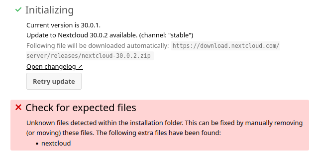

Hello I kindly ask support. While trying to udpate to version 30.0.2 the following error pops up:
Check for expected files
Unknown files detected within the installation folder. This can be fixed by manually removing (or moving) these files. The following extra files have been found:
nextcloud
How can I remove the file? Sorry by I’m not experienced.
Screenshot from 2024-11-17 15-10-13
You have to go to the directory where you installed the nextcloud server on your system and just delete the files on the commandline.
After they are removed, you can try to update again.
Go to the upgrader dir and enter:
sudo -u apache php updater.phar
In your case, you have an additional folder nextcloud. The reason may be a faulty copy or backup. While you’re at it, check that too.
