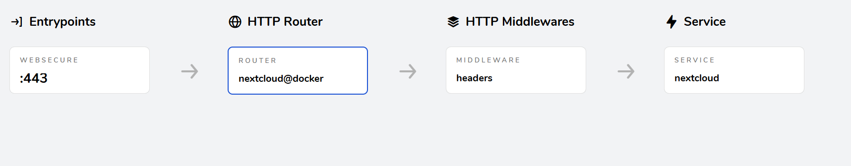

The ´limit´middleware shows up in Traefik:
But I can´t get it applied to the entroypint or service. I think it should show up here, as a middleware to work, am I correct?
How can I acheive that? Or should I be doing something completely different?
