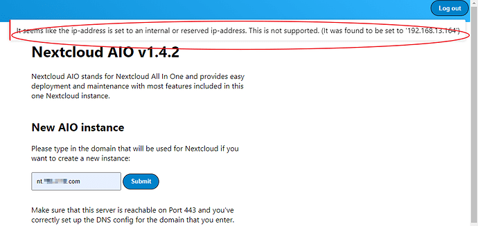

I’d like running Nextcloud in my internal network, so when I added a internal A record in my local DNS Server and type Nextcloud servername: nt.mydomain.com then click submit, I got error:
It seems like the ip-address is set to an internal or reserved ip-address. This is not supported. (It was found to be set to ‘192.168.13.164’)

So when I access nt.mydomain.com from browser I got the code as below:
![image|506x143](upload://t5GZ24qrzpsYtydJG6VxKAexTxK.png)
