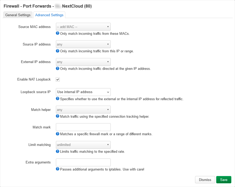

  2. Router is OpenWRT 21.02. I have double checked that NAT loopback is enabled and I don’t think this is an issue with the general router setup. All of my other internal server-like machines (HomeAssistant, MagicMirror, Linux file server) resolve in the LAN just fine.

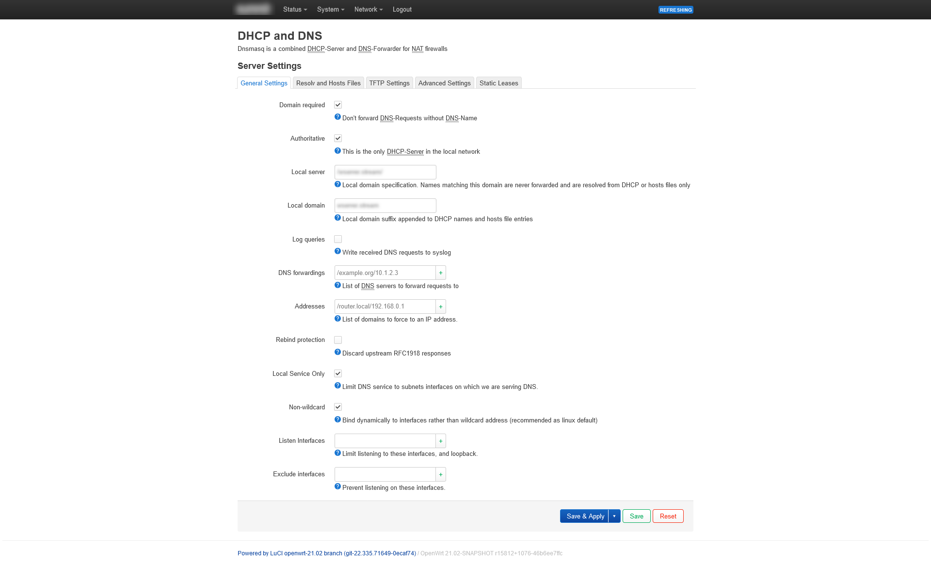

I found the rebind protection box in the DHCP seeting in OpenWRT and it was unchecked? Assuming that’s correct, right?

Also an additional piece of info. I just noticed that there is a line for NAT loopback on the NCP system info screen and it says “no”
As I said above, I double checked this (and rebind protection) on the router, but I’ve attached the relevant screens in case I missed something.
