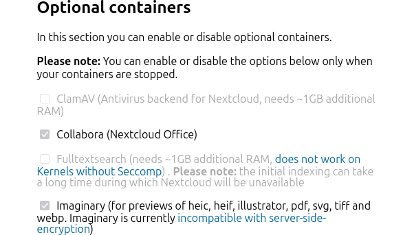

Hi, AIO comes with a dedicated collabora container that can be enabled via the AIO interface and should be used instead of the richdocumentscode app.
Hi @szaimen , thanks for the feedback. I enabled the Collabora (Nextcloud Office) from the AIO interface (see picture), and I’m happy to report that this works just fine :slight_smile:

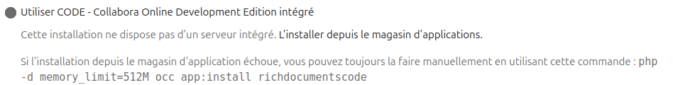

If my memory serves me right, it is different than what I had tried back in June, where I had not enabled that option but rather installed the CODE package from the App store. I will see if I can carve out some time to try that option again later.
This was this option that was causing trouble:
