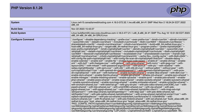

Not an expert, but it looks like it’s provided as a shared extension, instead of a static extension, as Nextcloud probably expects it to be. Maybe it’s possible to load it by adding it to the php.ini in the Nextcloud folder, but I’m not sure…

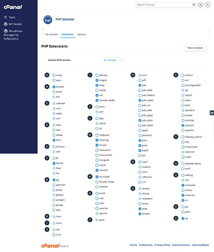

thanks. would be nice to know how to enable dynamic extensions. Web search didn’t turn up anything. I tried adding extension=gmp.so to my php.ini but it didn’t work.
Most distros have a package for both the GMP php module[1] and the dependency the for the module: the GMP library[2] itself.
Sounds like maybe yours doesn’t have the GMP library installed (which the gmp PHP module needs in order to be activated). Or maybe that you just need to restart your web server after updating your php.ini?
The check in Nextcloud Server[3] merely confirms if the extensions are loaded (active), roughly similar to running the php -m command (assuming CLI and mod_php/fpm mode PHP configs roughly match in your environment).
Not sure about CloudLinux specifically (what it appears your host uses), but gmp is supposed to be supported[4]. Might be something to ask your hosting provider.
