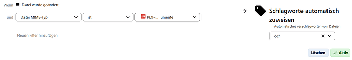

When Nextcloud recognizes a new file as a PDF, it is tagged and the OCR scan is performed.

  1. Define a rule to automatic tag a file
  2. Copy a file into the nextcloud data cp <SOURCE> <DESTINATION>
  3. Scan the Nextcloud folder occ files:scan --path=<DESTINATION>
  4. Check if the tag has been set
