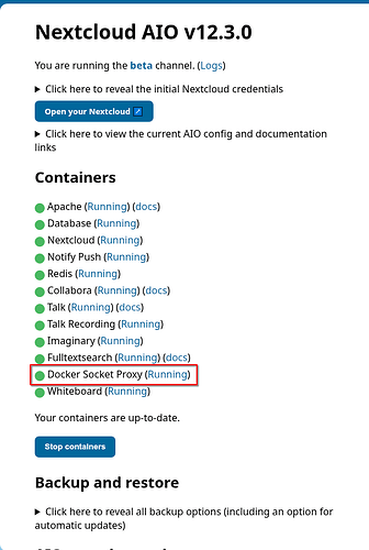

Hello everyone,
I’m continuing my testing with another Nextcloud AIO installation on a test server, where I used the latest Beta version 12.3.0 (Nextcloud 32.0.3). I applied the exact same settings, the same containers, and have the Docker Socket Proxy (Running) module enabled on both servers.

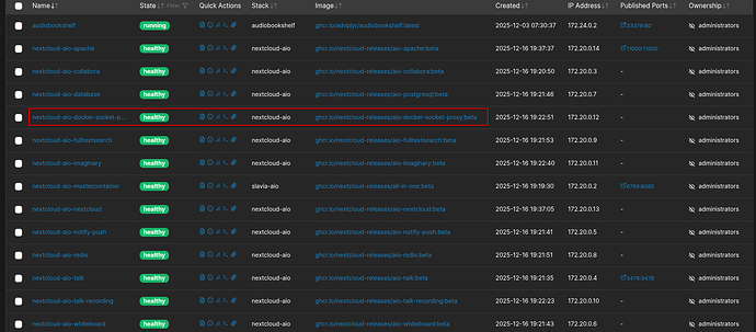

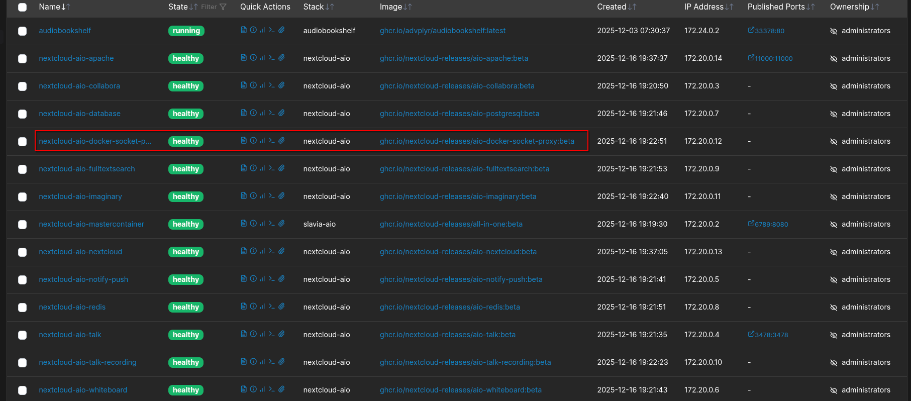

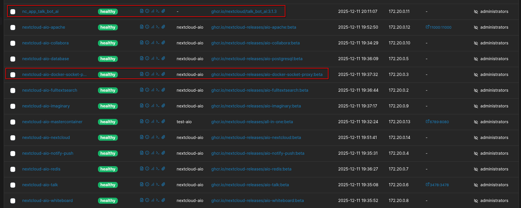

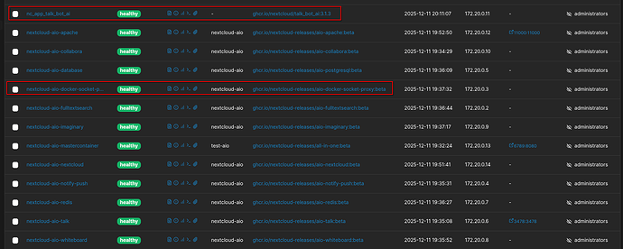

After installing and testing, I found that on the test server, a new Docker container named nc_app_talk_bot_ai was created and is running in a healthy state. However, this container did not get created on my home server, which could be the reason why the bot is not functioning properly.
Test server
Home server
The current version of Assistant Talk Bot is 3.1.3 on both instances, and the containers are running without any issues in Portainer. After comparing the running containers, I discovered that the presence of the nc_app_talk_bot_ai container on the test server could be the cause of the problem with the bot not working on my home server.
Could anyone advise why this container isn’t being created on my server? I’d like to figure out the cause and how to resolve this issue.
I have tried to disable/enable Assistant Talk Bot and nc_app_talk_bot_ai has appeared on home server now.
Gonna test it!
Edit: Finally working! :fireworks:
