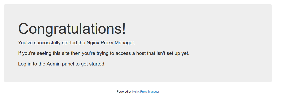

I have nginx master running on port 80, and visiting the port from my local IP brings up the page attached.
I also have it running on port 81 which is the one I’m using. How would I stop it from using port 80? I don’t seem to have a /etc/nginx folder
Edit: After some testing I realized that I don’t even need php or apache2 installed as everything is handled through docker, so I disabled apache2 and purged php.
I also have nginx in a docker container on host mode which I need for a service I’m running, and it discards mapped ports, so removing port 80 from the compose file doesn’t stop it from using it. Not an issue anymore though, as apache2 is donezo anyway.
