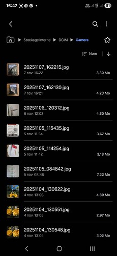

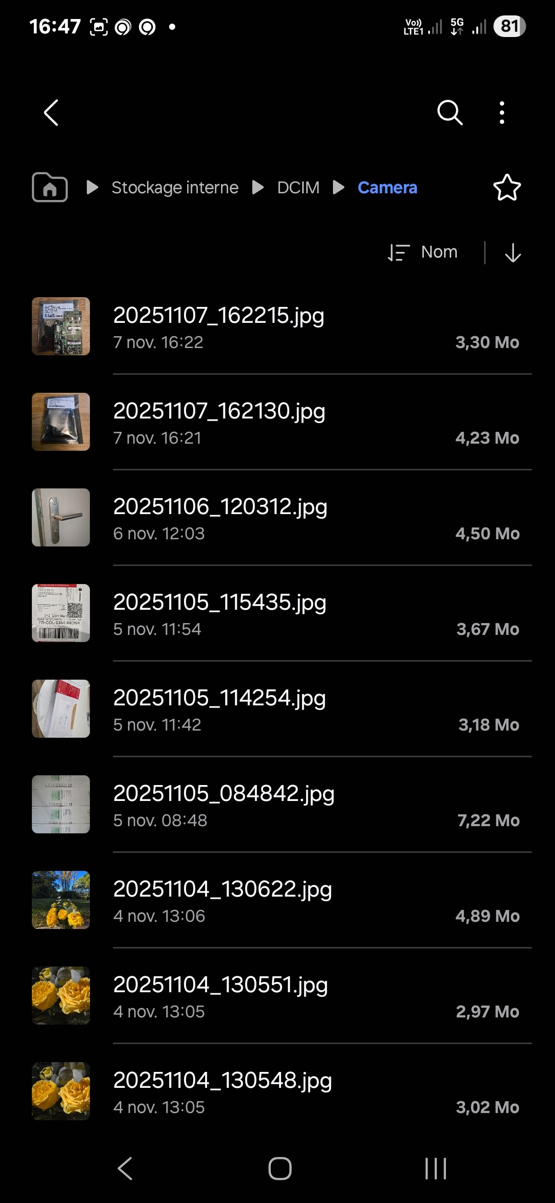

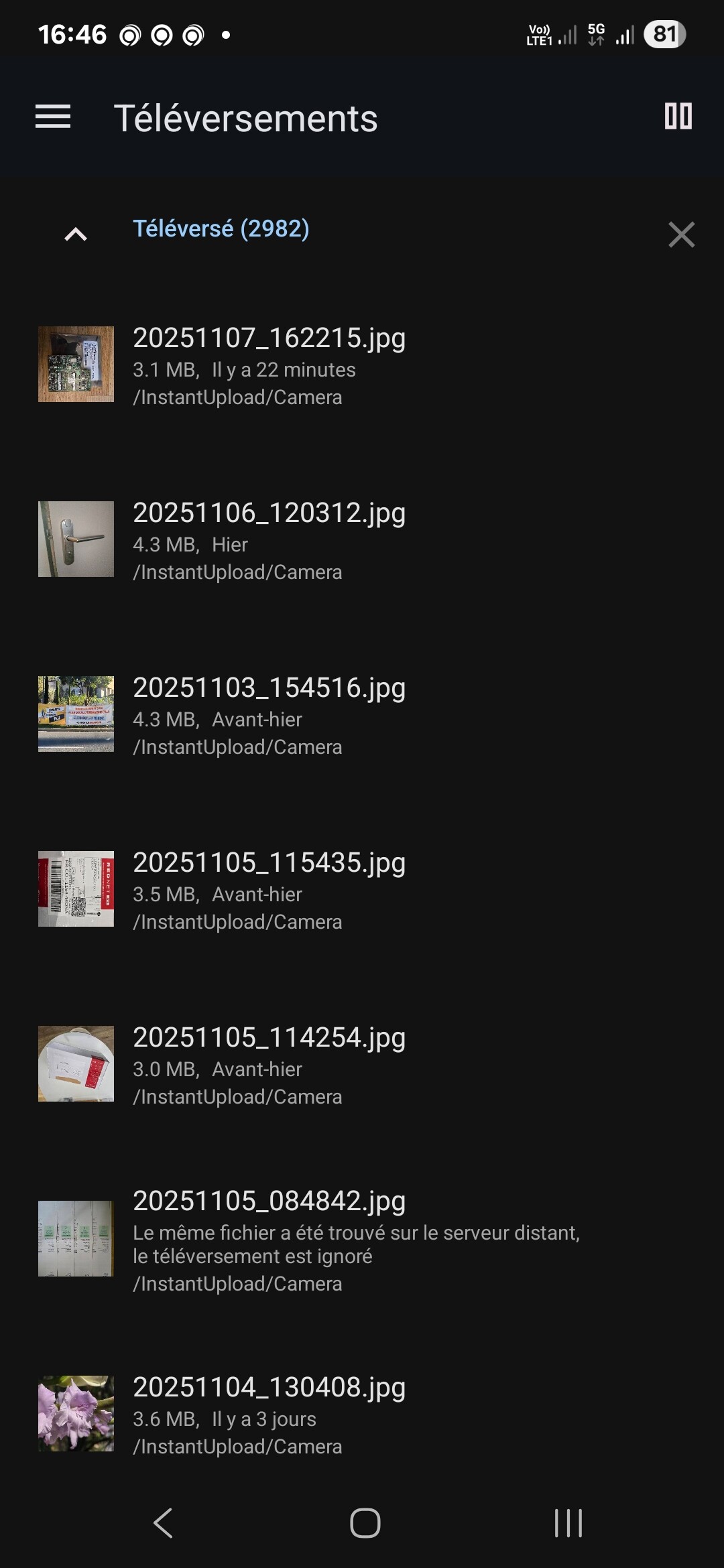

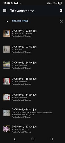

as you can see photo named 20251107_162130.jpg has not been uploaded but the one I took just after has been uploaded … why ? screenshot shows nextcloud uploads and the other one the list of pictures in dcim/camera folder of the phone

5 hours later the missing picture have still not been uploaded.
Newer ones have… so there is clearly an issue

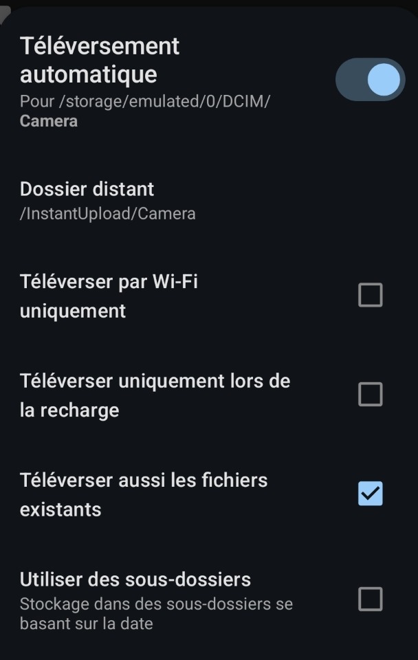

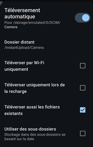

nextcloud has access to the camera folder has it is instant upload fonctionnality to upload pictures after they have been shot.
Options are like this :
