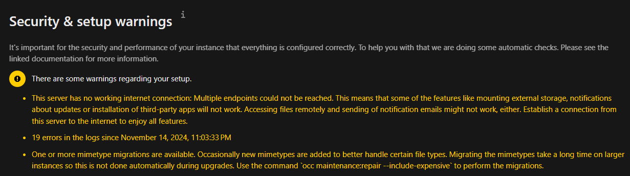

Now, if i try to do the same but from the inside of nextcloud-aio-nextcloud container i have no connection:
$ docker exec -it nextcloud-aio-mastercontainer wget http://google.com
Connecting to google.com (142.251.133.46:80)
wget: can't connect to remote host (142.251.133.46): Operation timed out
Also the nextcloud interface is telling me the same in the logs:
Now, if i manually export the proxy env vars within the nextcloud-aio-nextcloud container everython works just fine:
~ # wget http://google.com
Connecting to 125.1.1.xxx:3128 (125.1.1.xxx:3128)
saving to 'index.html'
index.html           100% |*****************************************************************************************************************************************************| 19956  0:00:00 ETA
'index.html' saved
In the AIO interface, i can see all the containers are in green and running just fine besides the notify-push which gives me the following error in the logs:
Connection to nextcloud-aio-nextcloud (172.19.0.12) 9001 port [tcp/*] succeeded!
The notify_push binary was not found.
Most likely is DNS resolution not working correctly.
You can try to fix this by configuring a DNS server globally in dockers daemon.json.
See https://dockerlabs.collabnix.com/intermediate/networking/Configuring_DNS.html
Afterwards a restart of docker should automatically resolve this.
Additionally, make sure to disable VPN software that might be running on your server
Also check your firewall if it blocks connections to github
If it should still not work afterwards, feel free to create a new thread at https://github.com/nextcloud/all-in-one/discussions/new?category=questions and post the Nextcloud container logs there.

Quick update:
I could fix it by editing the nextcloud_aio_nextcloud/_data/config/config.php and adding the line:
'proxy' => 'http://125.1.1.xxx:3128',
After restarting the docker service all the containers are working fine, even the notify push that was in yellow as mentiones above.
Any thoughts?
