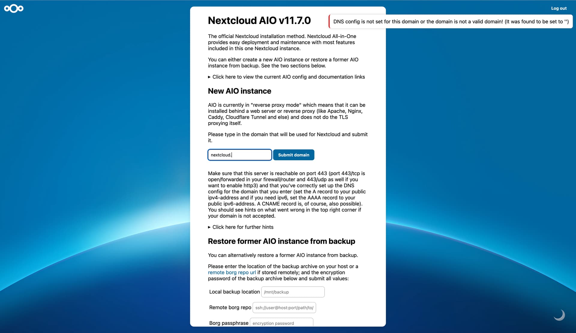

AIO v11.7.0 (Docker) - Error - DNS config is not set for this domain or the domain is not a valid domain! (It was found to be set to '')
    • Rocky Linux 10- up-to-date on 11.09.2025
    • AIO v11.7.0
    • Nginx Proxy Manager - jc21/nginx-proxy-manager:latest
    • AIO v11.7.0
    • Yes. I checked it online, but I could not resolve this issue with previous occurences.
    • While installing my new docker instance.
    • AIO behind Nginx Proxy Manager - docker
    • Yes, Cloudflare for certificates, but not externally exposed. All internal hosted.
I tried to install Nextcloud AIO behind a Nginx Proxy Manager on my local network to get valid Let’s Encrypt certificates and securly connect to my devices. I tried to set it up as simple as possible for the beginning, no redis, no portainer, no unneccesary containers. Just to get thinks running and test a bit the perfomance:

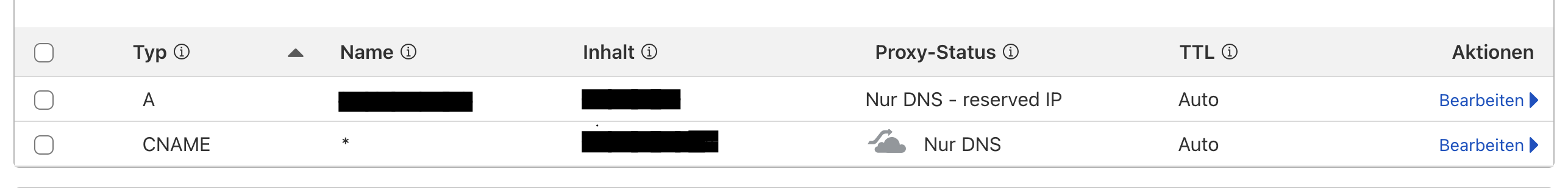

I also successfully set up Cloudflare:
A - domainname.domian to internal IP xxx.xxx.xxx.xxx
CNAME - * to domainname.domian
(API Token was created with the right permissions)

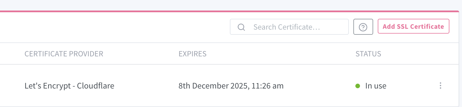

And Let’s Encrypt inside of my NPM: (works perfectly)

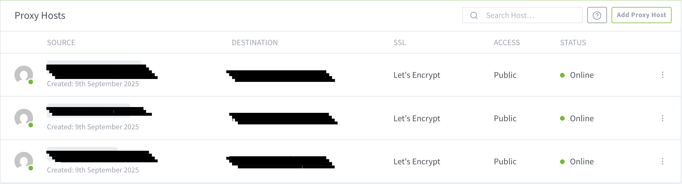

The entries are also working fine. If open them they respond immediately:
https://nextcloud-aio.domainname.domian to IP + Port 8080 (WEB GUI Access)
https://nextcloud.domainname.domian to IP + Port 11000 (Apache Expose for domain)
(All this works fine)
But I still getting this error:
DNS config is not set for this domain or the domain is not a valid domain! (It was found to be set to ‘’)

I removed my domain, but its this error as shown in the title.
