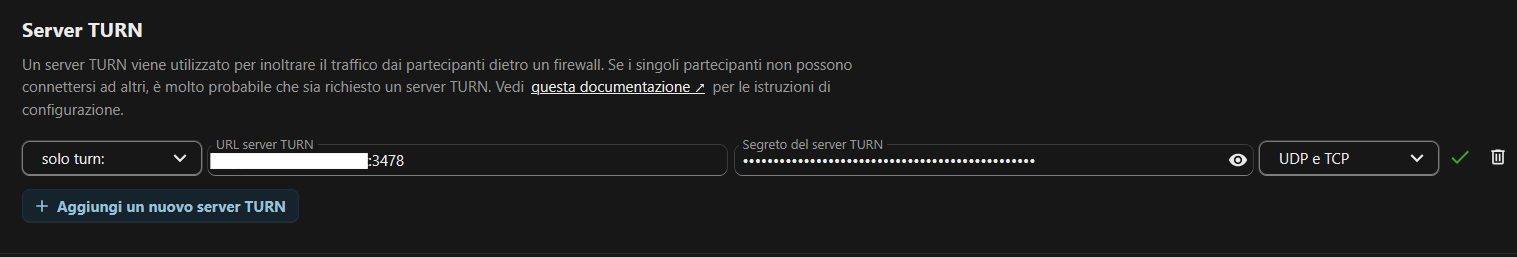

But is it HPB included inside AIO docker?
TURN seems to be working checking on Nextcloud admin panel, see the green tick on the right:
