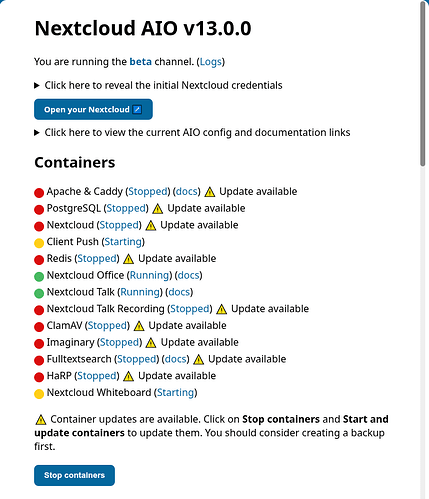

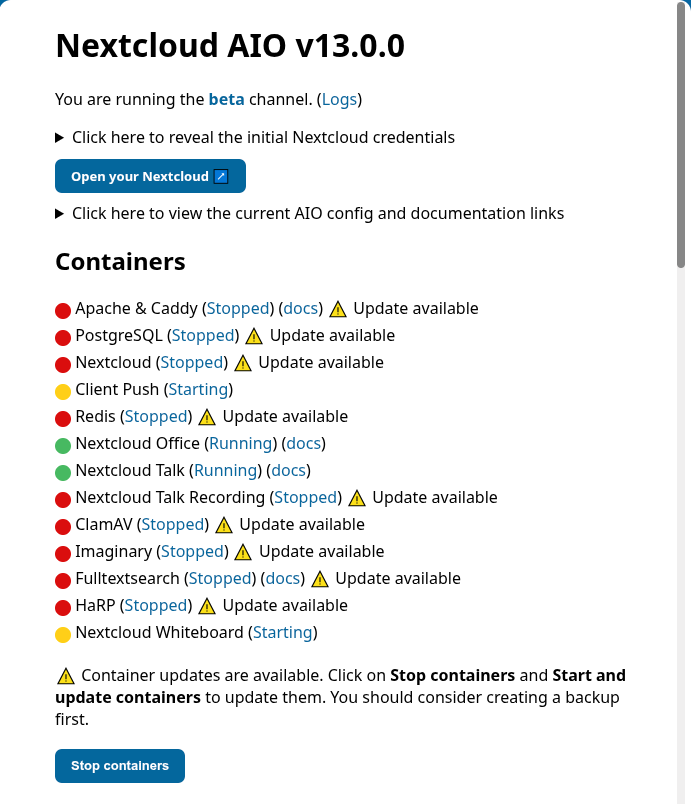

I can confirm that I’ve just experienced the exact same behavior during an upgrade from AIO v12.9.2 (stable) to v13.0.0 Beta.
This is the first time I’ve encountered this issue — I’ve been running Nextcloud AIO long-term and never had any problems with updates before.
My setup has been unchanged for a long time:
  • running behind Nginx Proxy Manager
  • same reverse proxy configuration as before
  • no recent system or infrastructure changes
So this does not seem to be caused by any modification on my side.

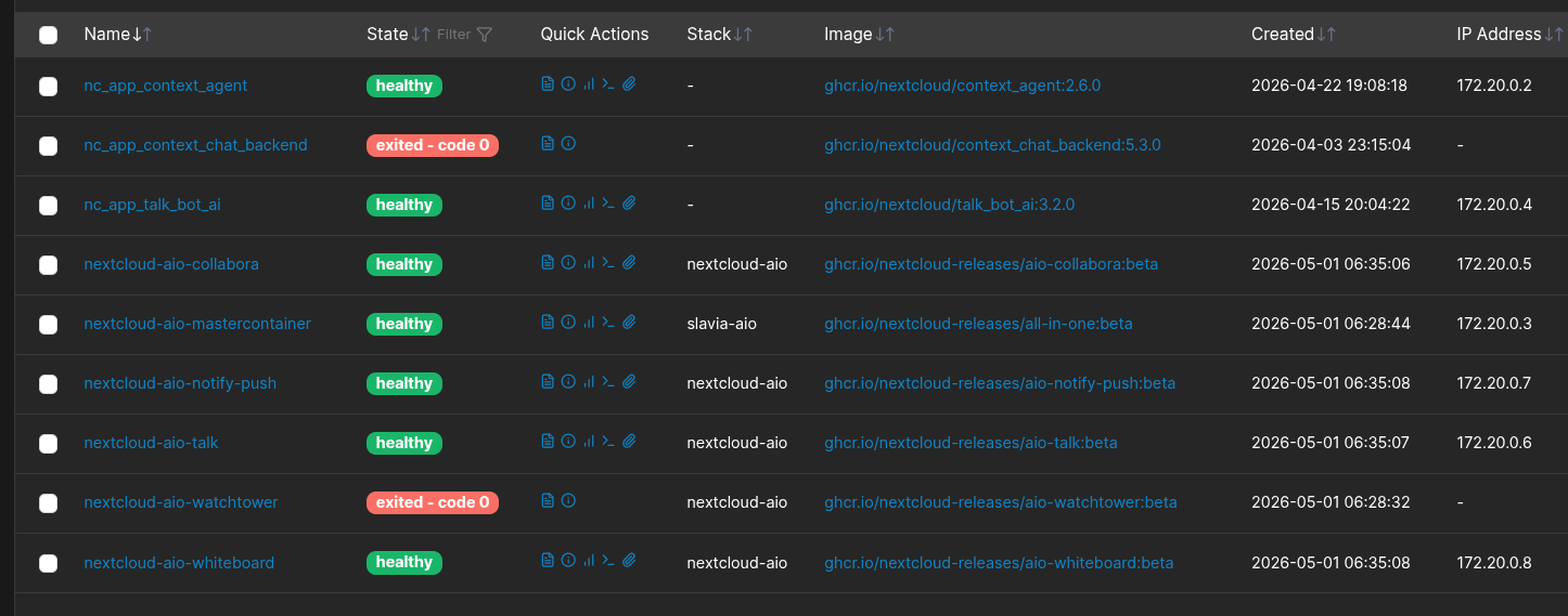

Portainer
Had exactly the same issue.
In my case, I’ve checked logs and it seems that there was an issue with Proxmox VM CPU settings that I’m using to run AIO.
After changing this to the one supporting AES and manually updating to Nextcloud 33.0.3 via phar update method I was able to download all missing (not updated in initial run) containers.
Only one thing left… FulltextSearch container is in boot loop failing to start.
