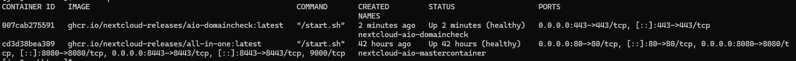

I’m planning to make a longer post about this, but I struggled for hours yesterday to get a web-facing NextCloud AIO instance set up on Linux Mint. No reverse proxies or local DNS tools (like Pi-hole, Dnsmasq, etc.) were involved, yet I kept getting the same Port 443 error as you. I finally just set skip domain verification to True, and happily enough, I was able to access NextCloud just fine.
With regard to the host, it does not matter if I use the DDNS name for my router; the private IP for my server, or sitting on the server using the localhost address. Here is the ACL in the router port forwarding:
I copied the run command from the Nextcloud AIO page on git. Here is the outputs of docker ps:
At any rate, I rm’d everything and ran the command below, then was able to access the container over port 443.
