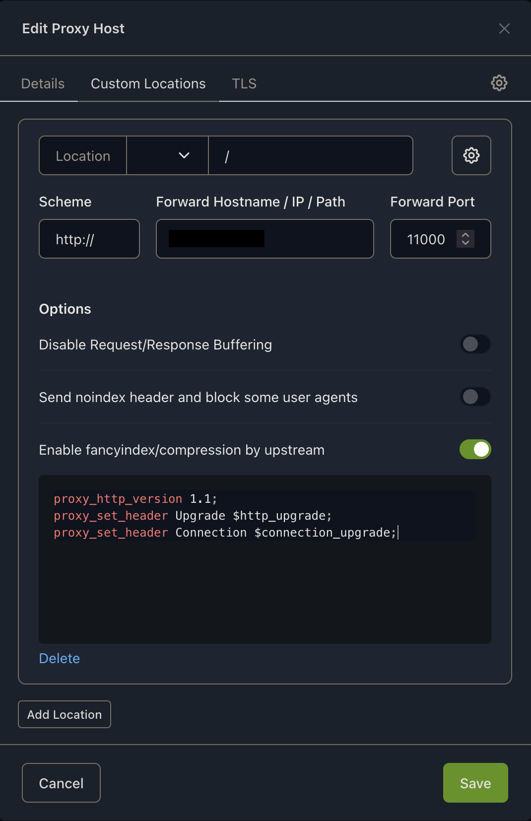

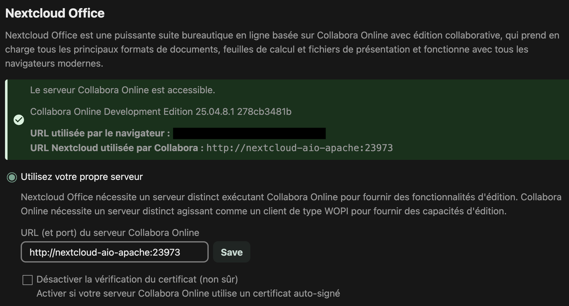

I can’t use Collabora to edit files when outside of local network, I get a websocket error. No issues when accessing from local network, it works like it should.
I’m running NPMPlus via Docker as a reverse proxy and the error is most probably coming from here. I think NPMPlus can’t access http://nextcloud-aio-apache:23973 because they’re not on the same Docker network.
I tried to follow these “On the same server in a Docker container” reverse proxy setup directions, but they can’t solve my problem:
  1. I can’t use host network mode on AIO because I have several other services running and so ports will conflict. AFAIK there aren’t environment variables available to manually set each port used by Nextcloud AIO, even though that could solve it.
  2. NPMPlus has to run in host network mode otherwise it won’t work. So I can’t let it bridge to my nextcloud-aio Docker network, nor can I use APACHE_ADDITIONAL_NETWORKenv variable.
I tried to set a custom DNS redirection on Adguard to redirect my.domain to my.server.ipbut that didn’t work. I also tried to add 0.0.0.0/0in the allow list for WOPI requests but that didn’t change anything.
Is there something I’m missing? Have I no choice but avoid using the built-in Collabora?

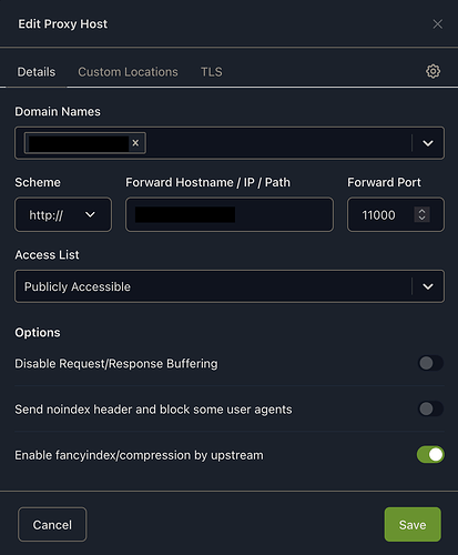

  1. Set up AIO using Docker compose and add the built-in Collabora container
  2. Run NPMPlus reverse proxy as a Docker container
  3. In NPMPlus, redirect your domain name to http://your.server.ip:$APACHE_PORT
  4. Try editing a file on Nextcloud web interface outside of local network
richdocuments : ClientException Client error: `GET https://my.domain/custom_apps/richdocumentscode/proxy.php?req=/hosting/discovery` resulted in a `400 Bad Request` response: <html><body> <h1>Socket proxy error</h1> <p>Error: no_glibc</p> </body></html>
The only error log I found when searching for richdocumentsis this :
2026/01/28 12:19:19 [error] 2057#2057: *2801 connect() failed (111: Connection refused) while connecting to upstream, client: client.ip.address, server: my.domain, request: "GET /apps/richdocuments/settings/fonts.json HTTP/1.1", upstream: "http://my.server.ip:11000/apps/richdocuments/settings/fonts.json", host: "my.domain"

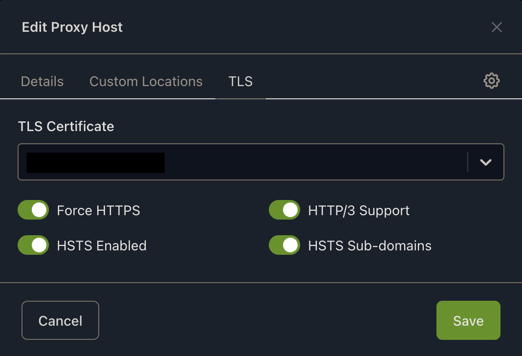

    if ($scheme = "http") {
        return 301 https://$host$is_request_port$request_port$request_uri;
    if ($http_x_forwarded_proto = "http") {
    more_set_headers "Strict-Transport-Security: $hsts_includeSubDomains_header";

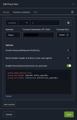

    location / {
        include proxy-headers.conf;
        proxy_pass http://my.server.ip:11000$request_uri;
        proxy_http_version 1.1;
        proxy_set_header Connection $connection_upgrade;
    # Custom
    include /data/custom_nginx/server_proxy.conf;
