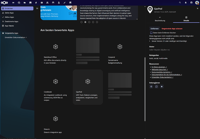

After the upgrade to NC 32, I don’t have the option to install apps anymore, since the whole app store seems to be “gone”.
I also notices, that sometimes I get a 504 Gateway Error when trying to open the Apps menu, which also didn’t happen before.
  1. upgrade to NC 32
  2. Go to Apps
  3. No new apps, only installed / disabled apps show up
