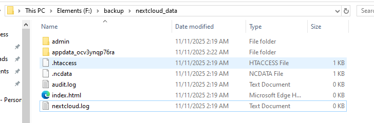

  • Typing nextcloud.local in chrome/any browser says :
This site can’t be reached
nextcloud.local refused to connect.
Try:
Checking the connection
Checking the proxy and the firewall
ERR_CONNECTION_REFUSED
  • If, localhost:11000 is typed in chrome, it redirects to nextcloud.local/login and same webpage is shown as above.
  • I have also added to my c:\windows\system32\drivers\etc\hosts file :
# Manually by Aanzil
127.0.0.1 nextcloud.local
192.168.1.8 nextcloud.local

along with emptying the space in :
F:\backup\nextcloud_data
But I could see some files are generated there :
