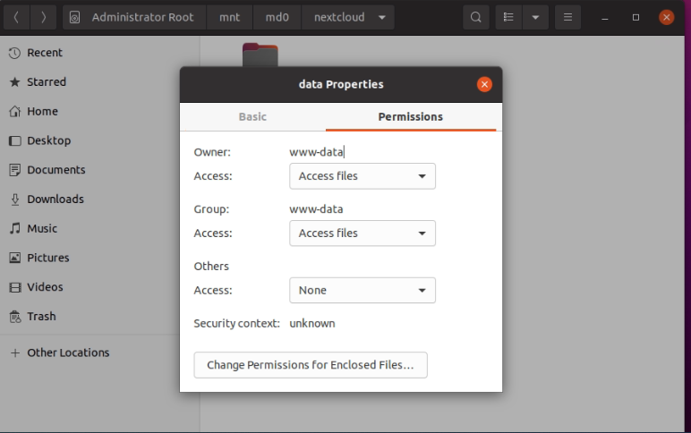

Here are the permissions of my data folder as of now :
NC config.php:
'datadirectory' => '/mnt/md0/nextcloud/data',
you made a wise choice to read up and setup on your own way.
simply look at your directories as user www-data
it needs atleast read access in /mnt/md0/nextcloud
and atleast write access in data
check owner of /mnt
if its root:root user:group so user www-data is other it needs read access here and execute as its a directory
if it 750 drwxr-x— change to 755 drwxr-xr-x
chmod 755 /mnt
do this for /mnt/md0 if not owned by www-data
from /mnt/md0/nextcloud the owner:group can be www-data:www-data and chmod 750 should be applied
