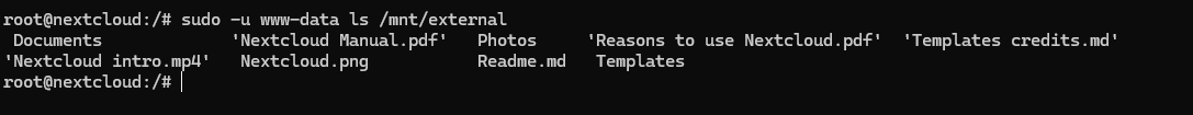

For the permission, you can check if the user www-data really has access:
sudo -u www-data ls /mnt/external

Had to copy files inside the folder because it was empty
